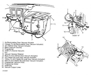

LAir works fine but will not come out at panal only floor or defoger

Tom you have either a bad servo on the diverter door, or a vacuum leak in the black vacuum line that comes thru the firewall, this line also goes to a check valve and vacuum resevoir, check all!

There are no vacuum hoses it's electric. I have the dash and lower panal off. There are two small motors on the right side I disconected both and moved the arm manualy that wasn't the answer. Where would I find the servo?

Now that I know whatI'm fixing...scan for "B" codes and it will tell you what part to replace! There are Vac operated parts, here's the diagram...
https://www.2carpros.com/forum/automotive_pictures/62217_Graphic_3.jpg
Friday, July 4th, 2008 AT 1:02 PM
MERLIN2021
  • 17,250 POSTS
Mode doors are controlled by vacuum actuators(servo) located on the left side of the heater case. Solinoids on the programmer control vacuum supply to the actuators. In my opinion one of the lines leaks, or one of the actuators is no good, use a hand help vacuum tester and test all the actuators. One will fail to hold vacuum!
