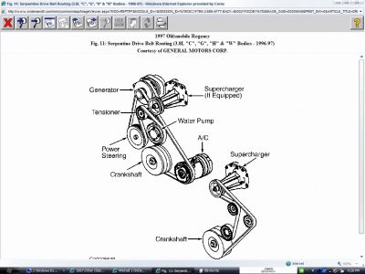

Need to replace idler pulley bought book but no help

Remove old belt by relieving tensioner pulley tension. Remove the old pulley,
