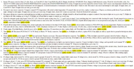

IS this statement still true:
"i can spray starter fluid and it will start for about 2 seconds and cuts right back out"
Try unplugging the sensor and try starting it.
https://www.2carpros.com/forum/automotive_pictures/30961_lss_1.jpg

Also try unplugging the cam sensor to see if it starts.
On this one it will affect fuel delivery. Also the coolant temp sensor can.
Please check for any current codes.
Dumb question but is there enough fuel n the tank....don't want to skip the basics and don't assume the gauge is right.
https://www.2carpros.com/forum/automotive_pictures/30961_lsss_1.jpg
https://www.2carpros.com/forum/automotive_pictures/30961_lssq_1.jpg
Send me an email if you can't read this.
servicewriter43@hotmail.com
Keep all communication here however.

Codes may still be present regardless of the cel.
You need the correct scanner.
Try unplugging the crankshaft pos sensor and the coolant temp sensor independently.
When you unplug the cam sensor, the pcm use a last known data. Cam sensor is not the problem based on that.
