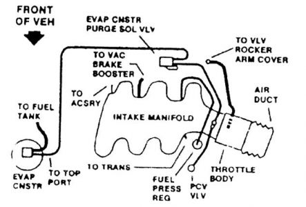

I need to know where the vacuum hose hook up to engine. Actually need the routing of vacuum hoses.

This is for a 95 olds cutlass supreme, 3.1 vin M
There might be a decal under your hood with the vacuum diagram.
