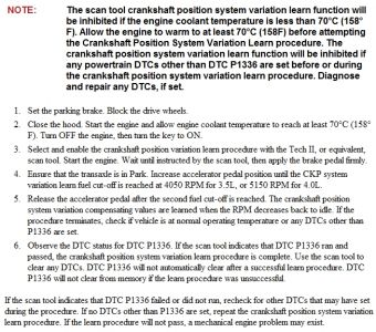

what kind of scanner do i need to perform the ckp procedure

can you use any scanner or does it take a certain kindto do this procedure.i have changed the cam sensor and disconnected the battery cable but still having same problem.

Tech II scanner
