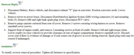

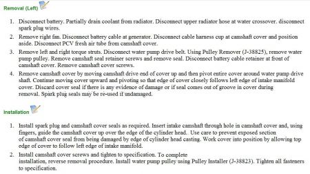

How to remove the valve cover on my 1995 Olds Aurora? There is a shaft that runs threw it.
