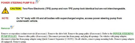

how do you remove power steering pump?

Hi there,
Pump removal as per data base info,
