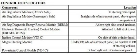

I have ECU/ECM issues coming up as trouble codes. I have a parts car that I bought with a bad trans and I want to grab all of the computers out of it but I don't know where they are all hidden. I found one behind the glove box with red, white and blue plugs. What is it? Where is the power steering computer, trans computer. So on? Thank you.
