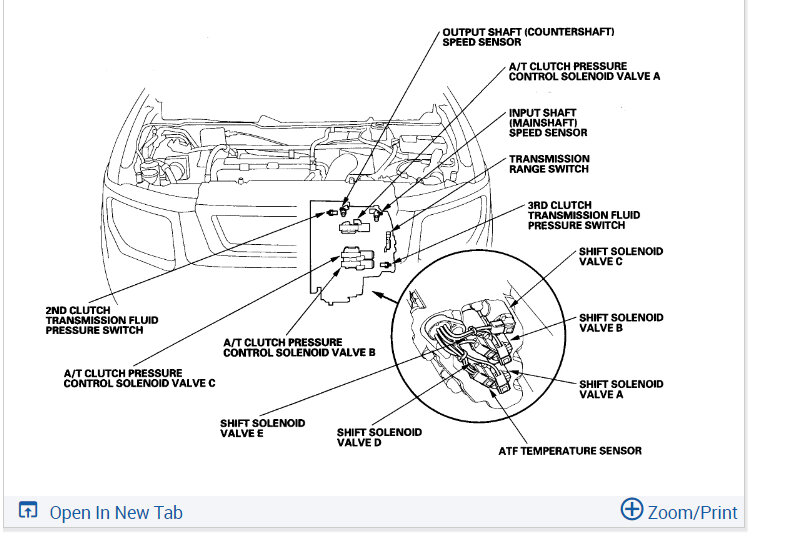

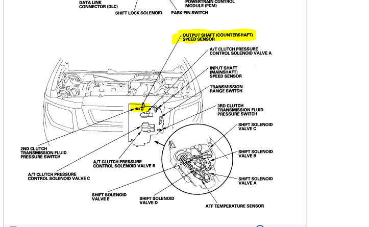

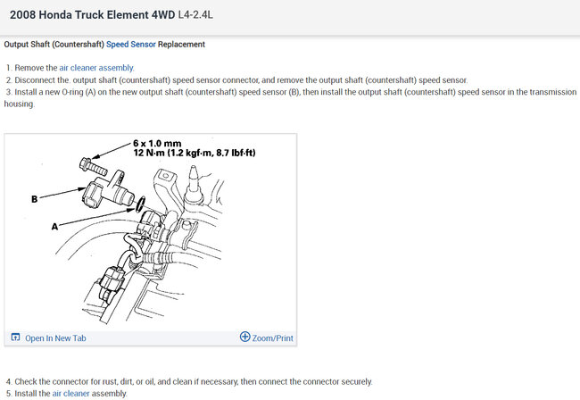

Code p0721, where is the output shaft speed sensor located?
2008 HONDA ELEMENT
14,000 MILES • 2.4L • 4 CYL • 4WD • AUTOMATIC
RICKEY68
  • 18 POSTS

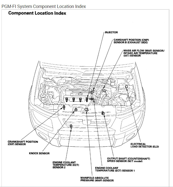

I have the vehicle listed above. It’s showing a code p0721 saying my speed sensor for the transmission is bad. Do you know where the output speed sensor is on the transmission? A guy said it’s beside the transition dip stick towards the left is that true? Do you have videos or pictures of where it is? Is this where the transmission speed sensor is located across from? The transmission dip stick towards the left?
Jul 12, 2024 at 2:30 PM
  • CERTIFIED EXPERT
  • 110,185 POSTS

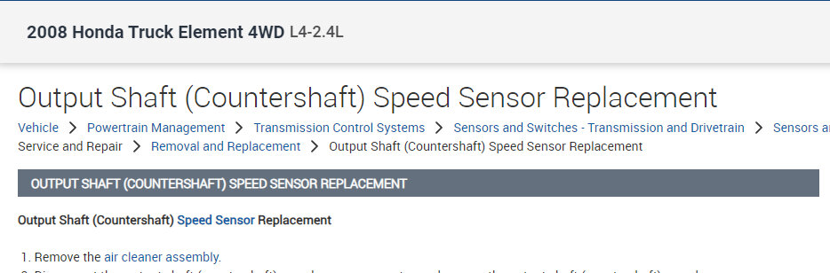

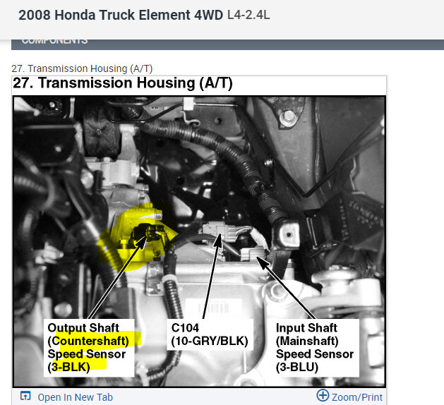

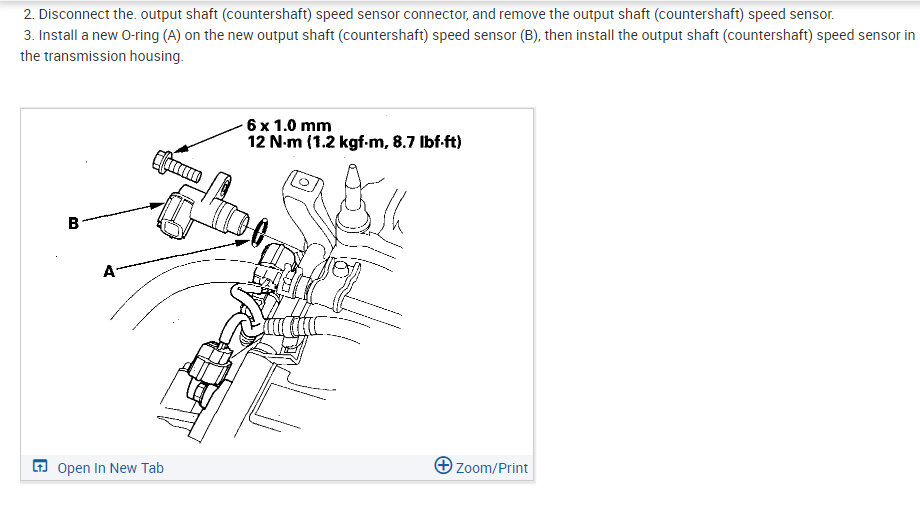

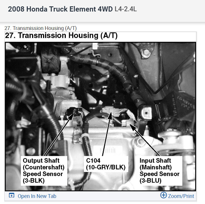

It is toward the front of the vehicle, mounted on the transmission. If you look at pics 1 and 2 below, that is what I was able to find to help locate it.
As far as the removal and installation is concerned, it is very simple. I attached the directions below as well. There is an O-ring on the sensor. When you install the new one, make sure everything is clean and free of corrosion on the transmission. Also, lubricate the o-ring with transmission fluid before installing it.
Just an extra thought. Take your time when removing the old one. They can corrode and be difficult to remove. Take your time and gently wiggle the sensor while pulling outward.
Let me know if this helps.

So, it’s not beside the transmission dip stick towards the left? But upfront closer to the radiator up that way? Because a Honda guy says it’s where the transmission dip stick is, and he said if you look towards the left it’s right there beside the dip stick of the transmission.
Jul 12, 2024 at 8:33 PM
RICKEY68
  • 18 POSTS
Okay, I found it, I have to take the air filter off to get to it right it’s under the air filter.

Sure, the output shaft speed sensor is located on the case of the transmission. here are three images and instructions on how to change it out. Check out the images (below). Let us know if you need anything else.

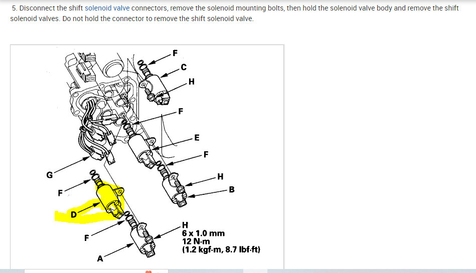

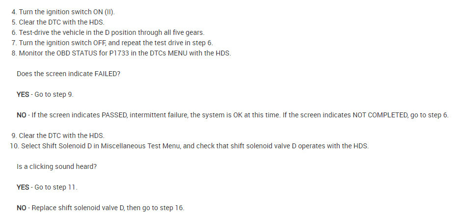

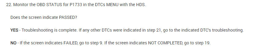

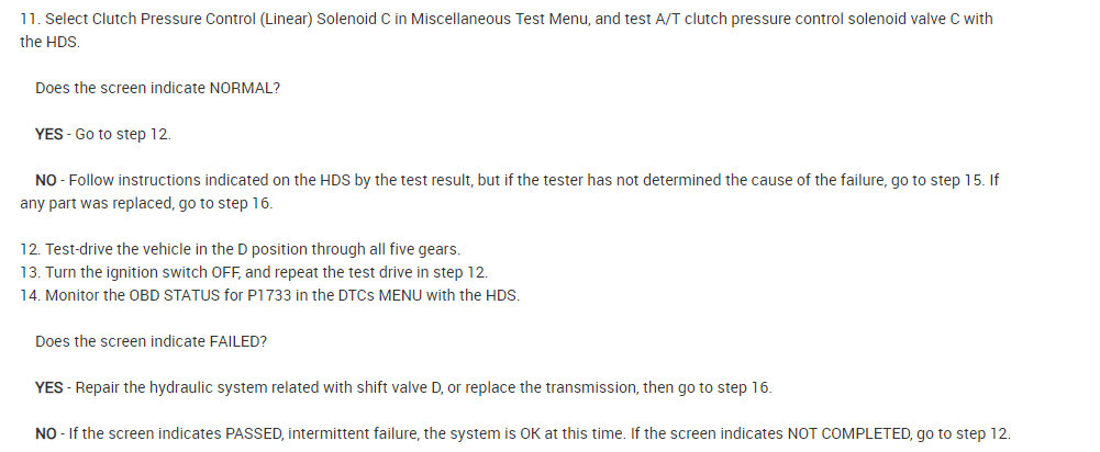

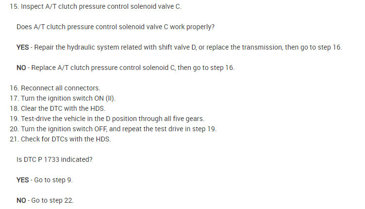

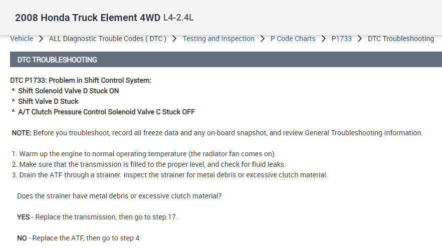

According to the manual, a P1733 indicates shift solenoid D is stuck on. That can be caused by a few things including dirt. Is the transmission shifting properly?
I attached the directions below for diagnosing it. Read through the directions and let me know if you are comfortable performing them.
Jul 30, 2024 at 12:06 PM

Ricky,

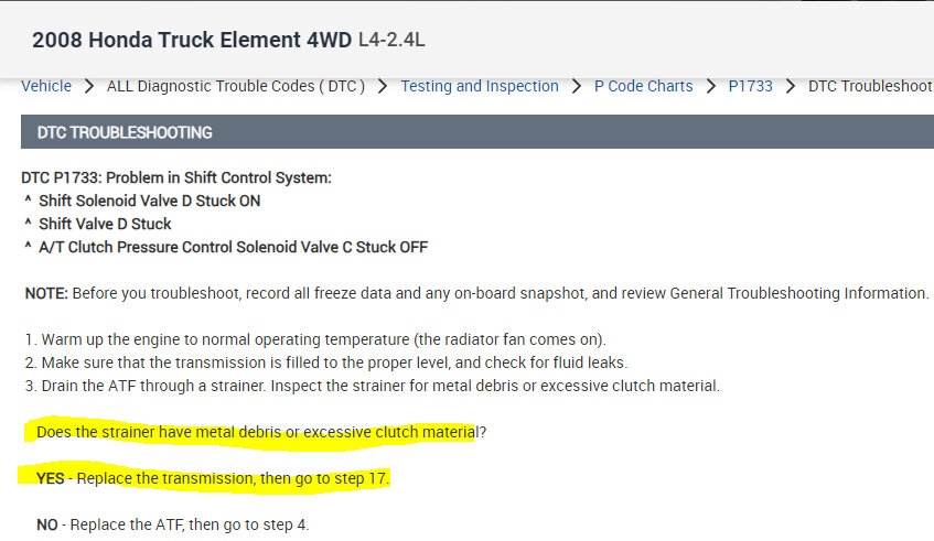

I wish I could call, but I'm not permitted. I'm required to keep everything online. As far as their determination, it is possible the transmission is failing and needs replaced.
Did they explain how they came to that determination? If there is excessive metal or clutch material in the fluid, the manual indicates replacement. But, I don't know if that is what they checked.
See pic below.

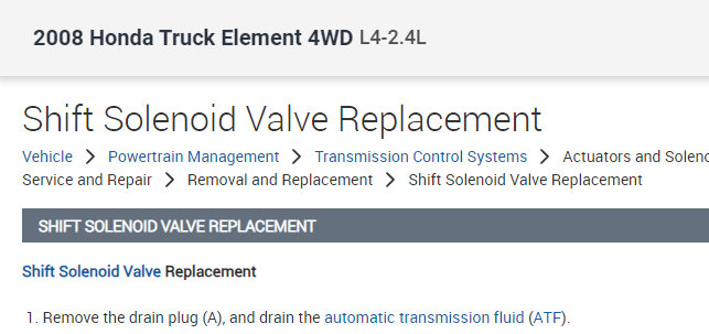

Where is the solenoid D at if it was dirty where would I have to change it so you know where it’s located so I could take it off and change it? Because I took it to Honda dealership and put it on a computer they never said anything about a solenoid D that’s what I told them that shaft D was coming up a code.

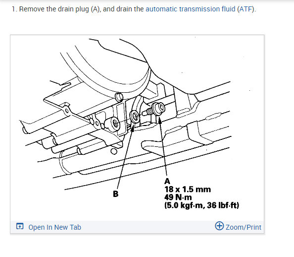

  • CERTIFIED EXPERT
  • 110,185 POSTS

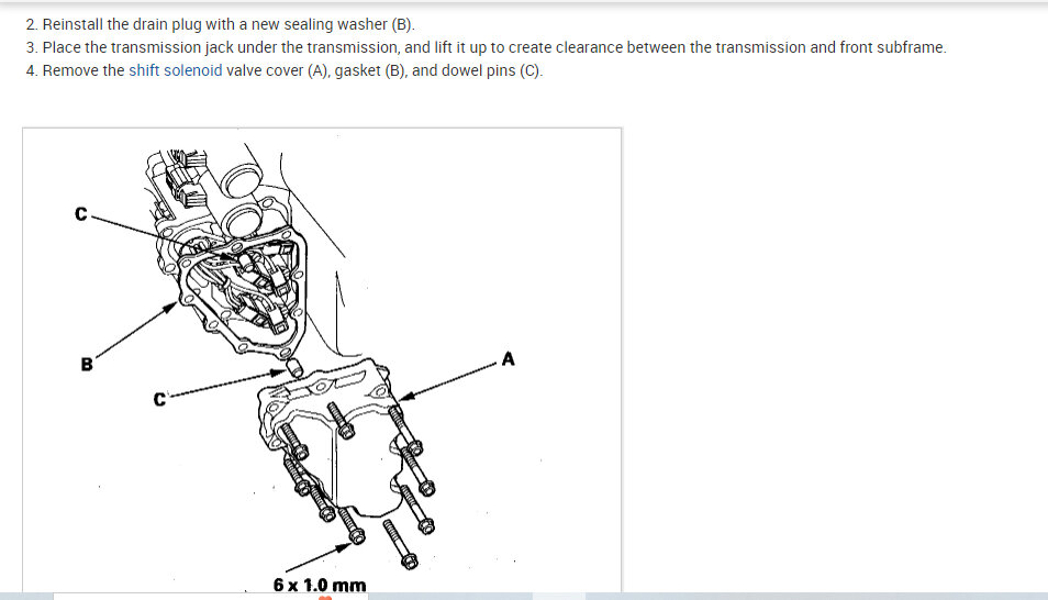

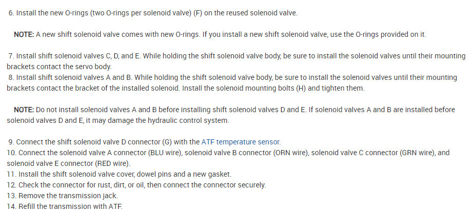

The solenoid is located inside the transmission. I attached the directions below for replacing them.
I highlighted solenoid D.
