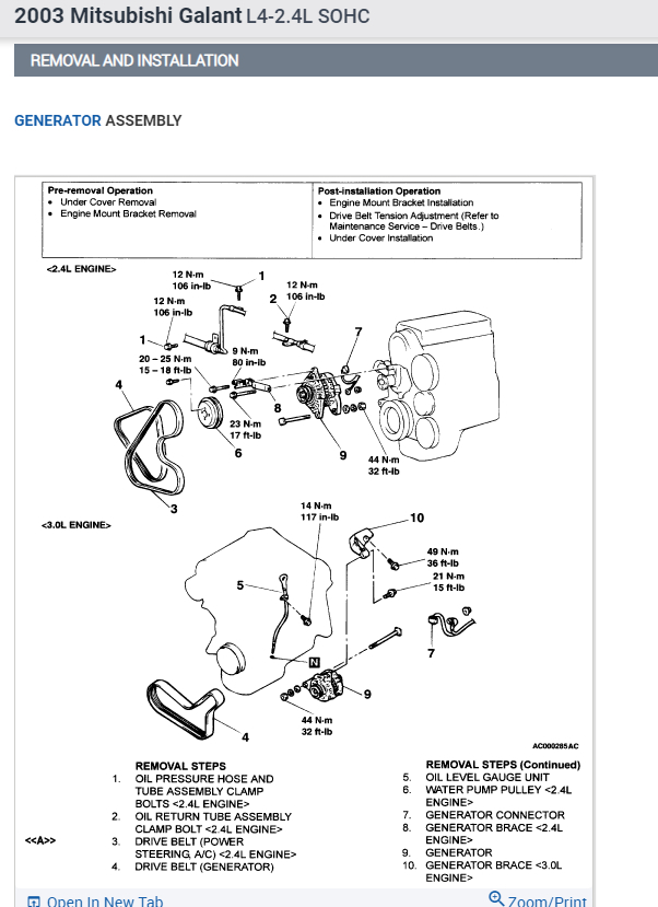

I was curious if 4g64 engines have the same alternator as a 4g63 or maybe a Hyundai G4JS engine alternator or even a G4CS.

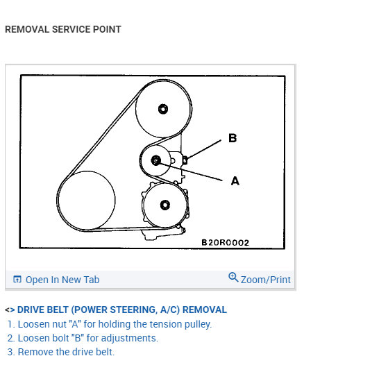

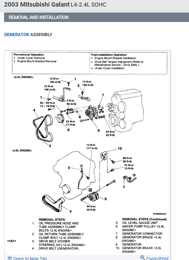

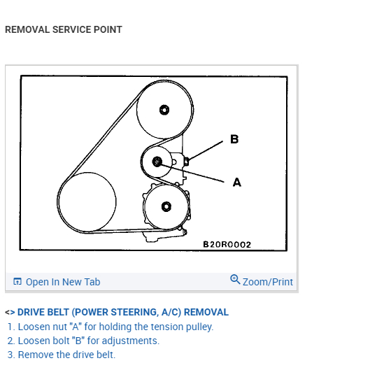

As far as the catalog goes, it calls for different part numbers for the alternators, likely they have different internals and mounting points.
From 2000 - 2003 these 4-cylinder Galant's use the same alternator.
Factory part# M368519D.
https://www.2carpros.com/articles/how-to-replace-an-alternator
