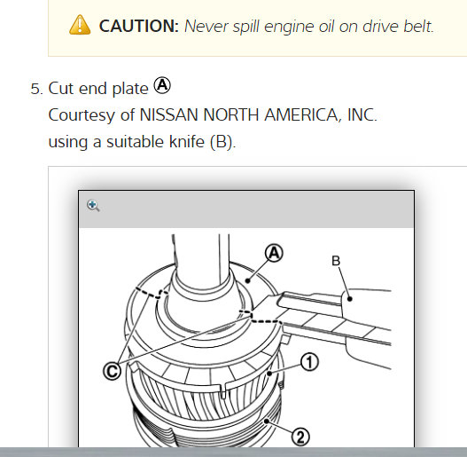

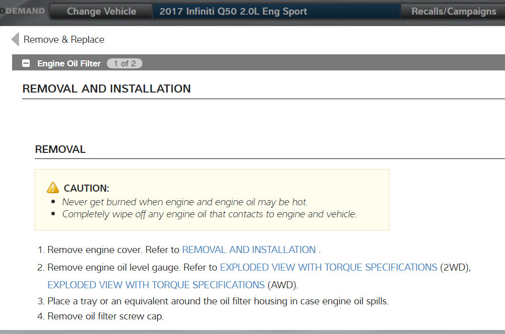

How do I remove the oil filter canister from the top of my engine the cold air intake is blocking me from reaching it,it is a 2017 Infiniti Q50 2.0t

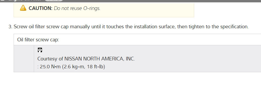

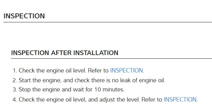

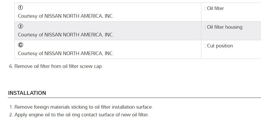

I have included the directions that you have requested in the diagrams down below. Please go through this guide and get back to us with how things turn out.

My car is a awd 2017 Infiniti Q50 2.0t this doesn’t show me how to get to it,it’s on top of the engine and the cold air intake is blocking it.i know if i bend it taking it out I will have a problem.My problem is moving stuff to get to it.
