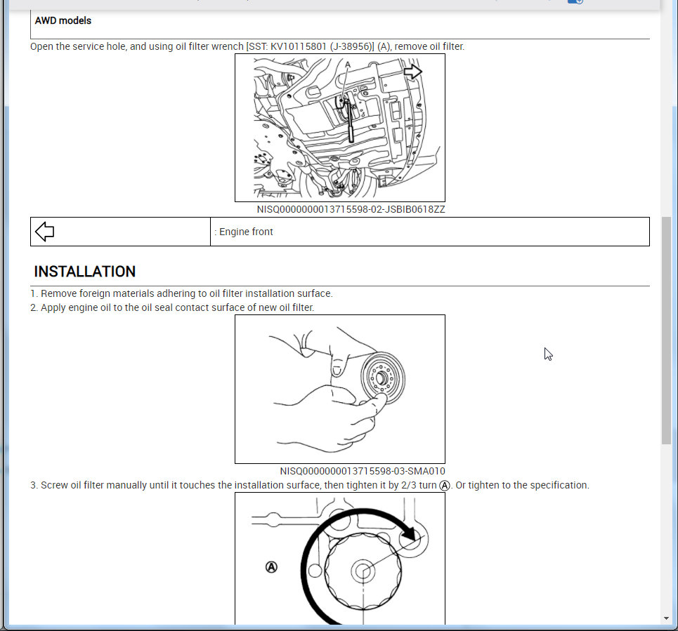

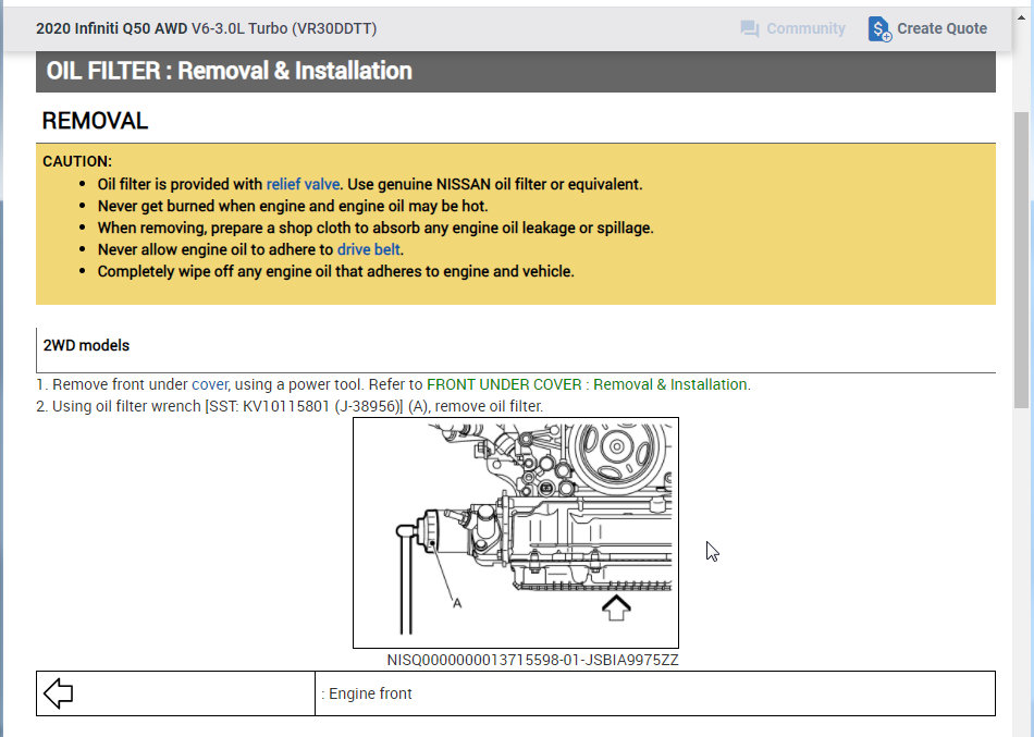

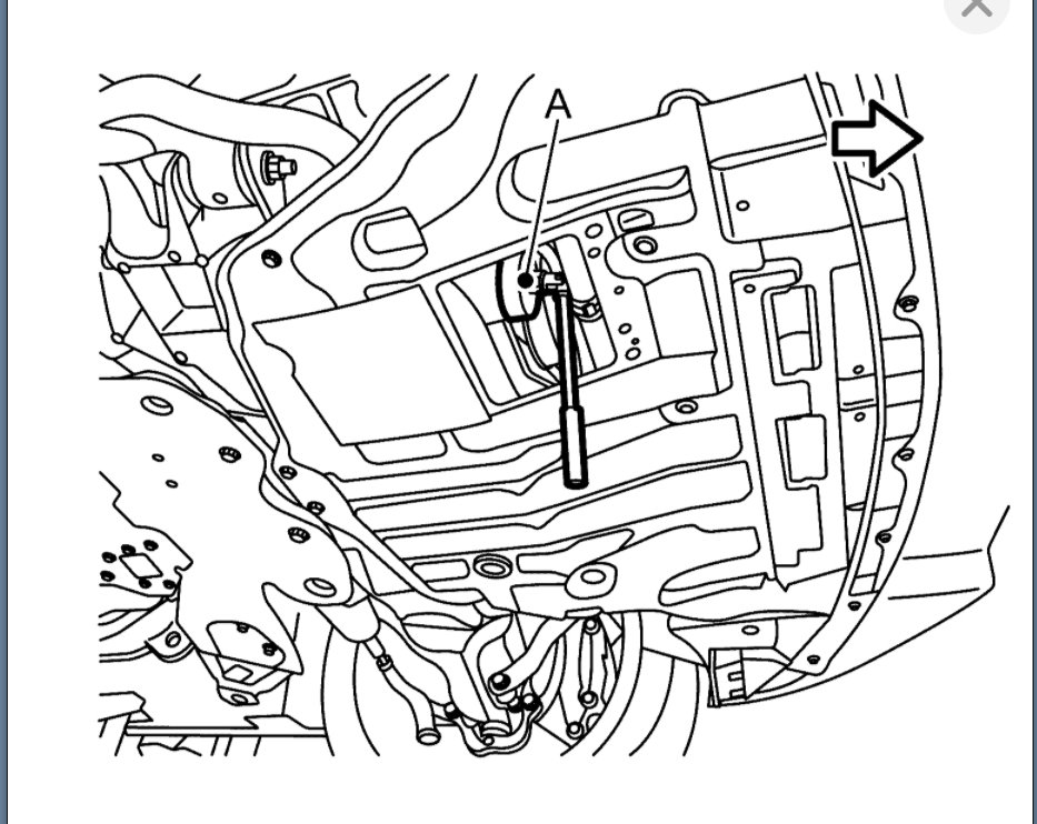

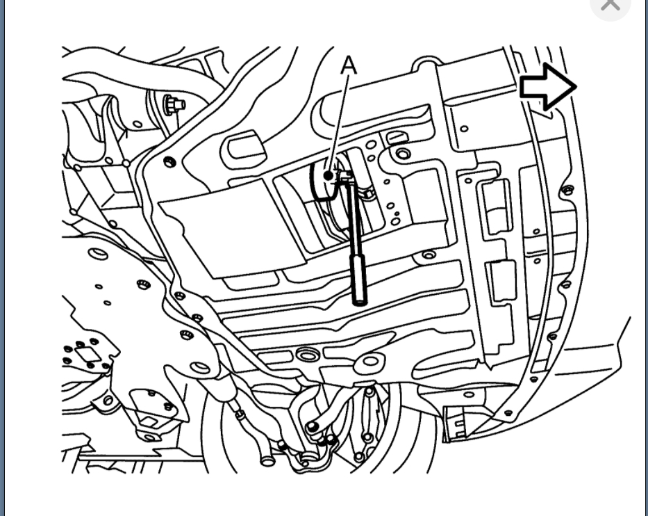

Where is the oil filter located and how is the best way to reach it?
Thanks, Joe
Dec 17, 2020 at 8:59 AM

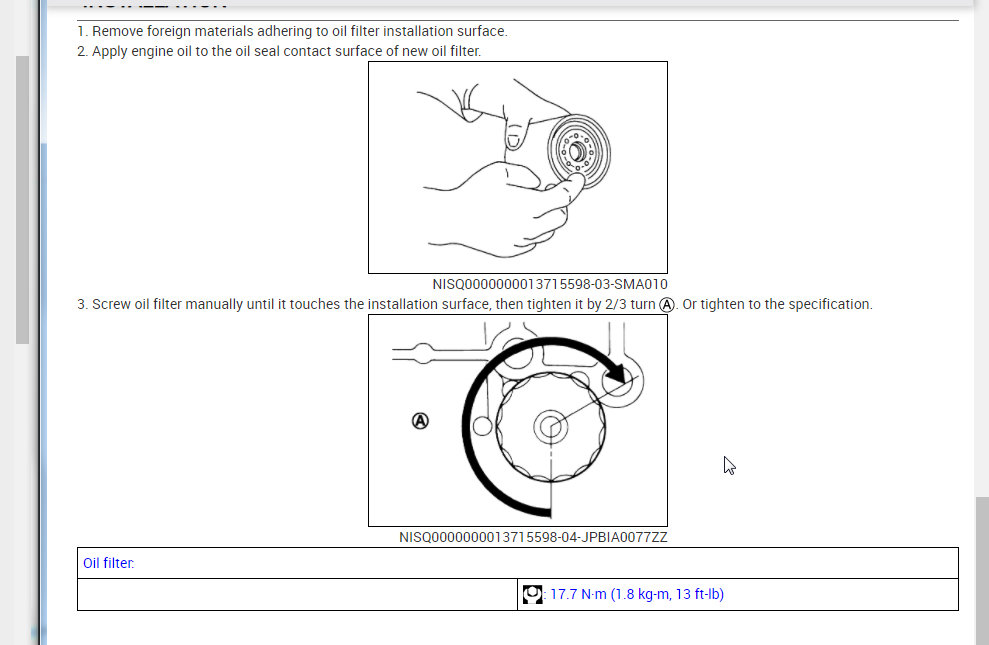

Since your vehicle is an AWD vehicle, they kind of hid it on you. I attached the info from the manual. If you don't have a lift, you may want to invest in a jack and jack stands if you don't have them either. This is going to be a tough one to get to on your back with no jack.
