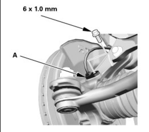

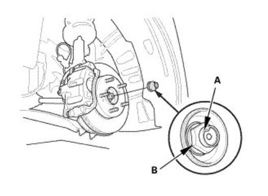

During turning left or right it has a noise. Also, when driving on high speed it produces a lot of noise than normal.
When you turn the steering wheel you can feel the spring making a noise like the McPherson is dry any thing I can do to quiet it down?
And whats the issue?
Aug 25, 2017 at 4:54 AM
  • 54,128 POSTS

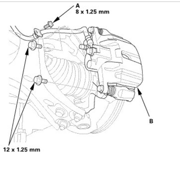

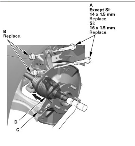

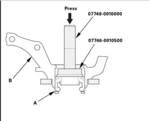

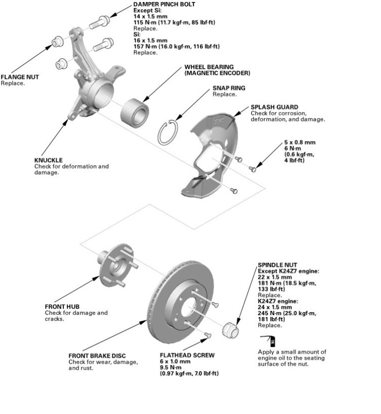

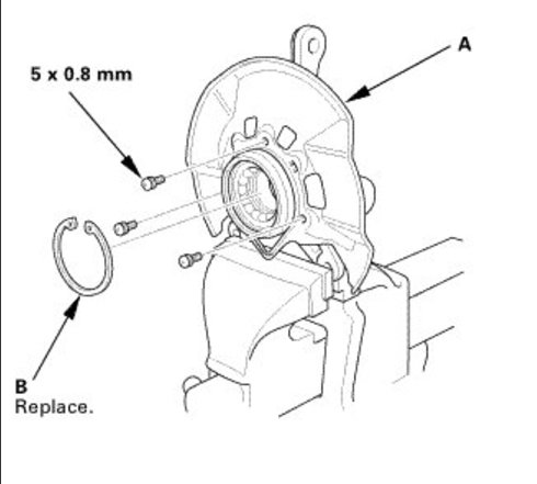

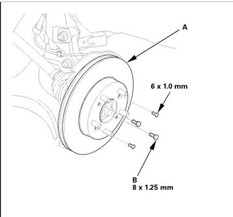

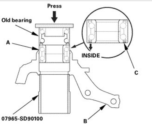

Can you take a video of the noise and give us a link? We have found it is must easier to hear the noise then to try and guess it at. If I were to guess I would say you have an axle bearing that is out.
Here is a guide to help you see what you are in for when changing the bearing:
https://www.2carpros.com/articles/how-to-replace-a-cv-axle-bearing
Here is what it is on your car:
Aug 26, 2017 at 11:39 AM
ARRANALFIEE
  • 6 POSTS
Your guess is right. I had talked to a mechanic and he pointed out the same thing. You are a very experienced person. Hats off! You were able to detect the problem just by reading. Its so great.
