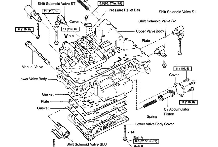

looking for help on a transmission diagnosis. throwing code p0750 shift solenoid a malfunction.
Do you have a repair manual or diagram of the solenoid positions inside the transmission? i need to know which one to replace. thanks

Good evening
Below is a diagram of the valve body for you to view.
do you have a scan tool that can activate the solenoids?

i have a code reader ,but no tool as you describe. The code says P0750 shift solenoid a malfunction...which one is A? i have no second gear , and no reverse.

Okay, you need the scan tool to work the solenoid to see if it functions.
it could also be a stuck valve in the valve body. have you had the transmission fluid and filter changed?
Shift solenoid S1.
