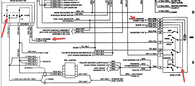

1993 FORD F-250
5.8L
V8
2WD
MANUAL
90,000 MILES
How to check for problem?

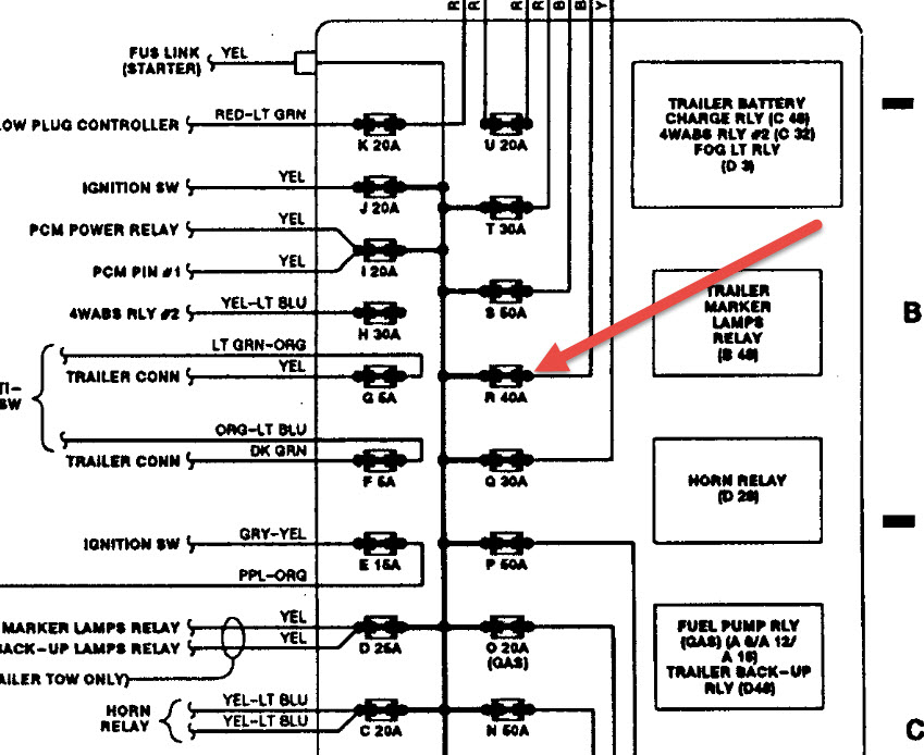

Then check fuses in picture under hood fuse box and switches see if power is going from all of them. Finally check ground by battery it may be corroded and not completing circuit.
Images (Click to make bigger)
