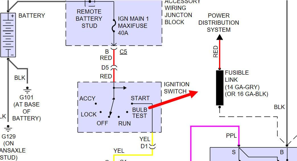

I the SE model. The starter is good but still will not crank over. Battery is also good.

If you have one try another key. The diode may be bad in it. I am assuming that the engine turns over but will not run.

My husband says that it does not turn over at all.

Check the fusible link that runs off the starter that is the usual cause as well as fuse in picture.
Image (Click to make bigger)
