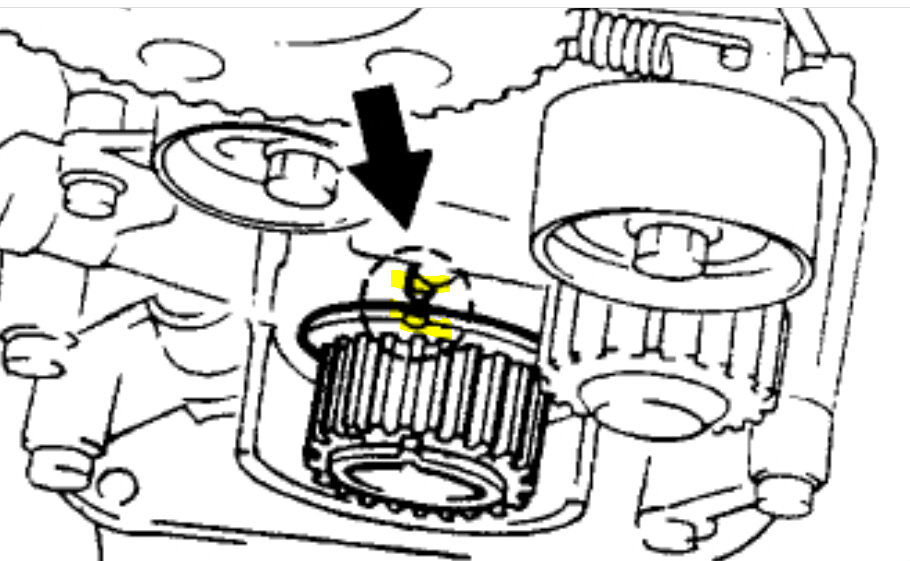

Recently replace the head gasket on my truck. Now it will not start. It has 25 PSI compression after doing compression check.
Turns over just fine. Has hydraulic lifters so no valve adjustment is necessary. Getting fuel and also has spark.
Tuesday, January 3rd, 2023 AT 2:36 PM
15 Replies
  • 110,194 POSTS

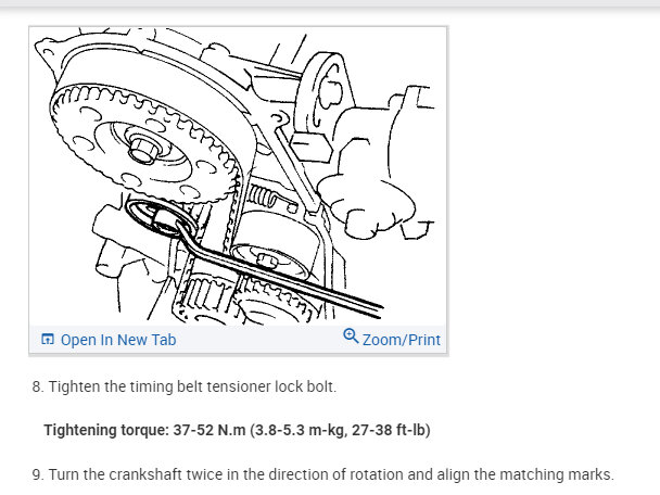

Is the 25 PSI compression on all cylinders? Are you sure the timing belt/engine timing was installed correctly? If it is out of time, this will happen.
If possible, record it cranking and upload it for me to hear. Also, if the compression is 25 PSI, it won't run.
I attached some important information for the installation of the timing belt. Take a look through them and let me know if this is how you did the repair.

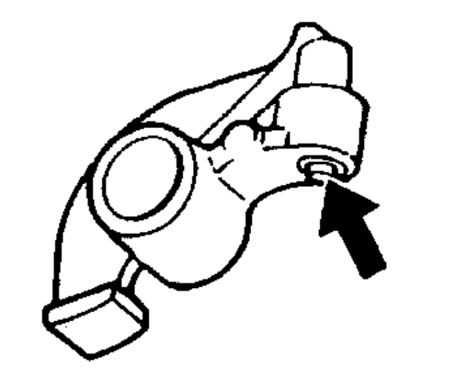

At TDC the rocker arms on #1 cylinder were all the way up. If I understood correctly that means the valves are open?
Wednesday, January 4th, 2023 AT 7:06 PM
  • 110,194 POSTS
I'm not sure why someone would tell you that. The valves need to be closed when the cylinder is at TDC.

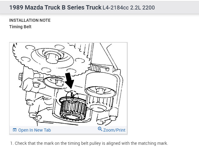

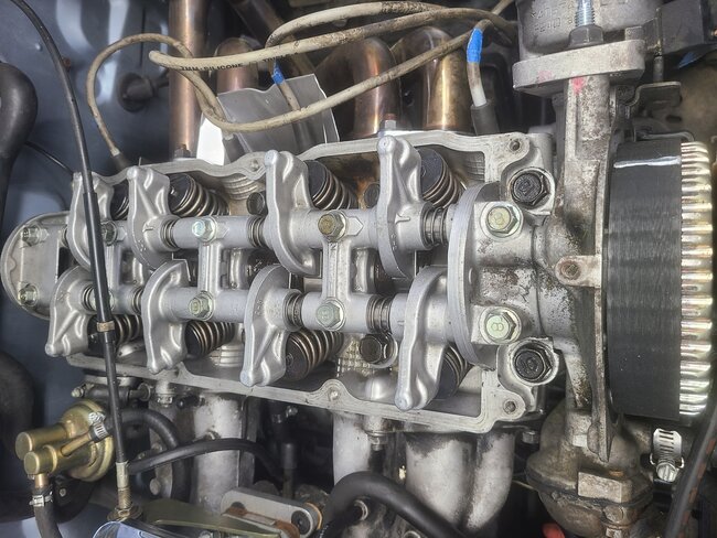

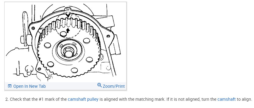

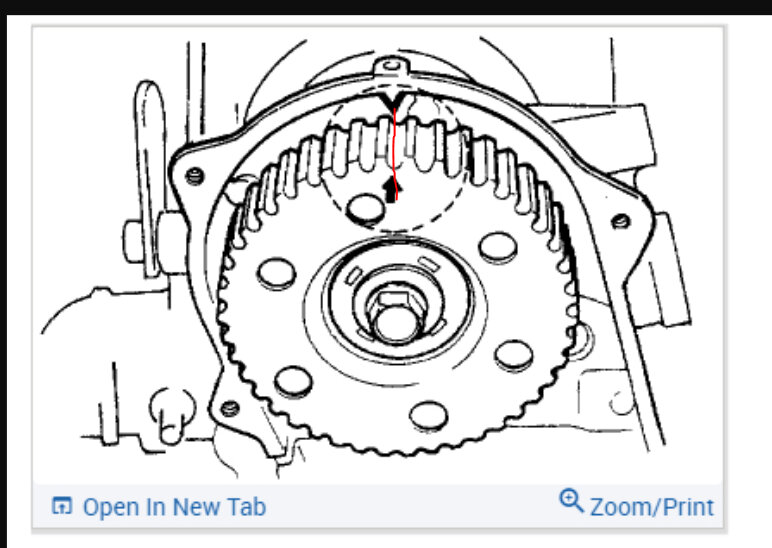

When timing the engine, there are marks on the crankshaft and camshaft that need to align. Take a look at the attached two pics. Pic 1 shows the camshaft and pic 2 shows the crankshaft marks. Check to see if they are aligned. If they are, the timing is correct. If they aren't, that is the likely issue.
Also, look at pic 3 below and let me know which side was all the way up.
Let me know what you find.

Yes, the timing marks are lined up. On Pic 3 the rocker arm is all the way up. On both the intake and exhaust.
Wednesday, January 4th, 2023 AT 8:53 PM
  • 110,194 POSTS
If the side that has an arrow on it is all the way up, the valves should be closed, which is what we want. However, if you are one or two teeth off with the timing, they can be in that position but open too early causing low compression.
Unless the head is leaking equally at each cylinder, the compression rings are totally faulty, we have an evenly warped head, or the valves in each cylinder are equally stuck open, timing is the only other thing that makes sense. The aforementioned possibilities are nearly impossible to happen.
Did you remove the timing belt cover to check the timing marks? Can you take a few pics of the timing marks, rocker arms, and valves so I can see what you are dealing with?

Yes, I did remove the timing cover, the arrows do line up, as well as the mark on the crank. This is the only picture I have taken so far and saved.
Thursday, January 5th, 2023 AT 8:48 AM
  • 110,194 POSTS
Thanks for the update. It's hard for me to tell from that picture. Can you tell me what the white line on the belt is for? Also, the belt doesn't appear to be running true on the cam pulley. Looking at a picture, I can't be 100% sure about that, so let me know.

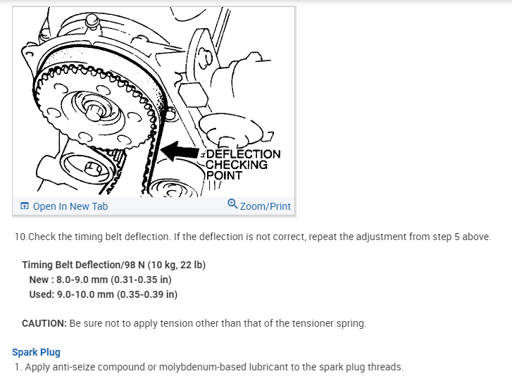

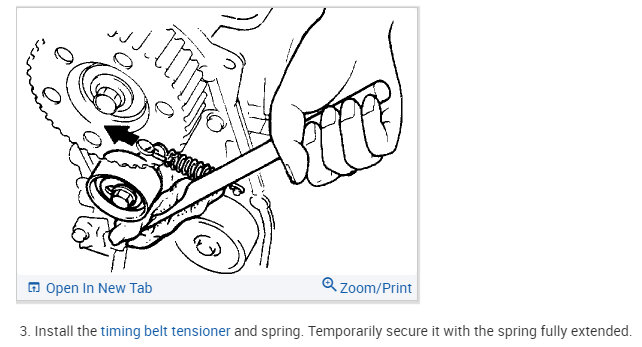

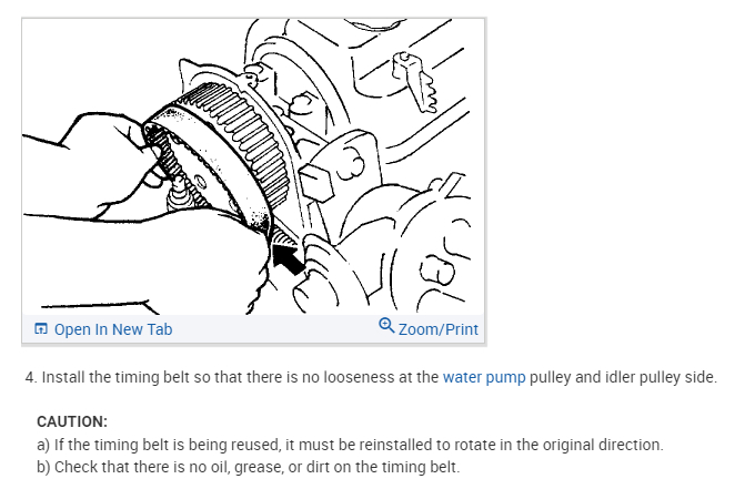

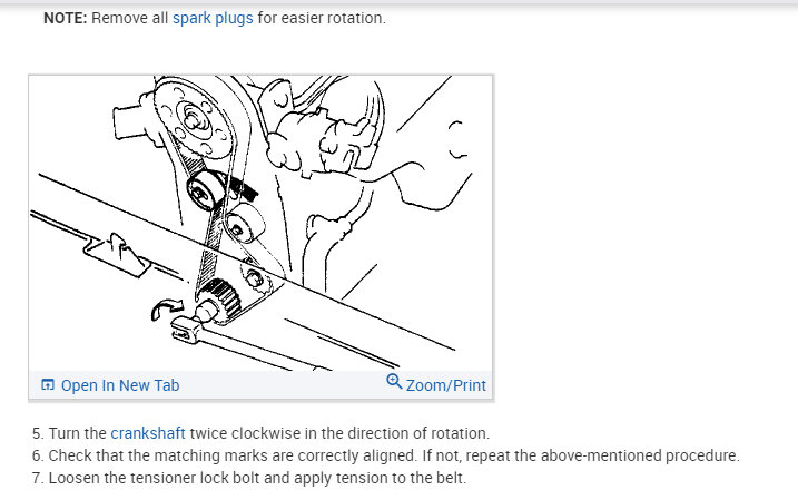

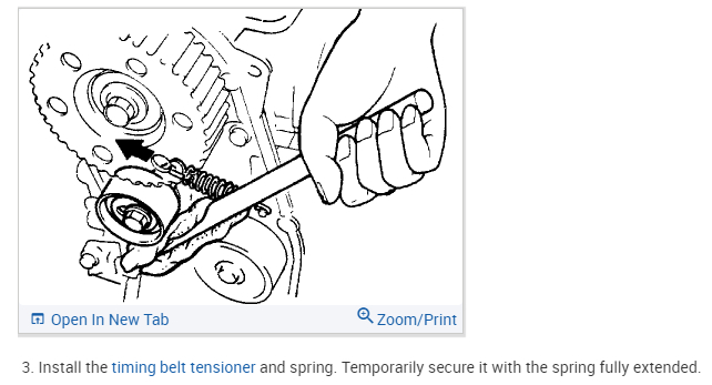

Update, the timing is off the timing on the crank is off of TDC 1 mark forward. We moved the belt a tooth back and it moves it off 1 mark backwards. The timing belt tensioner pulls is also missing (must have broken) so I believe that the missing spring is not allowing for correct timing.
Monday, January 9th, 2023 AT 10:07 AM
  • 110,194 POSTS
Thanks for the update. The timing was my first suspect. I attached the directions for the installation of the timing belt above. Take a look through them and let me know if it helps.
