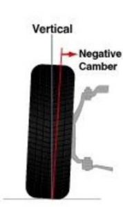

https://www.2carpros.com/forum/automotive_pictures/444192_tireguide2_460x0w_1.jpg
It's currently disassembled this picture is what my problem is. Sorry it took so long, been busy.
How do I adjust camber?

You have to use shims between upper link spindle and upper link bracket.

Upper part of your suspension upper spindle link and upper spindle bracket. Look for the spindle youll see bolt. You put the shims there.

No problem. But remember when you change caster camber will change too.

Well I thought I figured it out, though I can't seem to get the tires straight. Can you explain what caster is? Thanks.

Helps vehicle corner and wheels straighten out after a turn. Negative is when the tops of the wheels are in more then the bottom. Positive is the opposite. Is yours negative or positive.

Positive, I've been doing trail and error with shims. It's getting old doing this process over and over haha.

If its positive your going to want it to come in as much as possible.

Took a little trail and error with the shims, you've been a great help, got everything aligned thanks!
