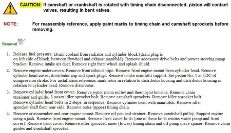

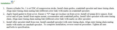

Can you help me with repairing the timing chain on my 96 nissan sentra
