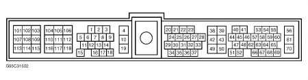

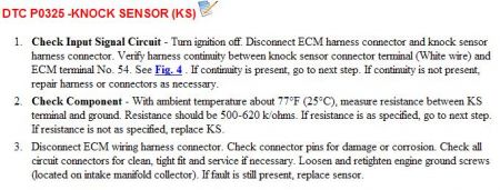

How to test the ks?
Friday, August 14th, 2009 AT 8:26 AM
BLUELIGHTNIN6
  • 16,542 POSTS
https://www.2carpros.com/forum/automotive_pictures/261618_Noname_817.jpg
FIG. 4
https://www.2carpros.com/forum/automotive_pictures/261618_4_13.jpg
