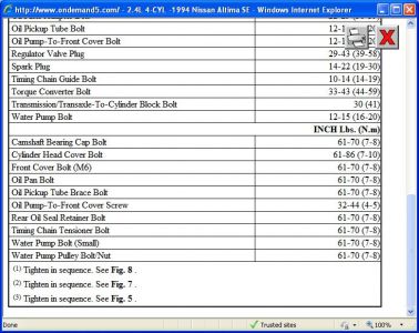

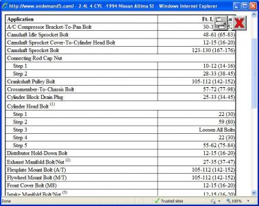

I Need The Torque Specs For The Head Bolts, Cam Sprockets and Cam Brackets?

There you go.

Is it foot pounds or inch pounds on head bolts
