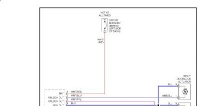

7. Power doors (locks and windows) Does not work at all on both driver and passenger side doors. How can I fix this?

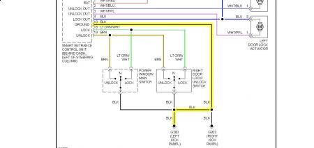

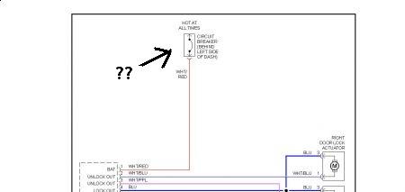

Check the circuit breaker behind left side of dash if okay check for power at the smart entrance control unit white and red wire if you got it here and you have good ground on G200 left kick panel, and G203 right kick panel all these okay Send the SECU to the trash can, its defective
https://www.2carpros.com/forum/automotive_pictures/12900_d1_6.jpg
https://www.2carpros.com/forum/automotive_pictures/12900_d2_5.jpg
Wednesday, January 13th, 2010 AT 1:05 AM

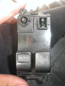

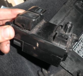

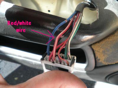

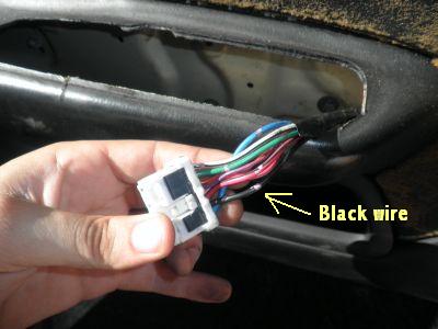

7. power doors (locks and windows)
I opened the door panel and saw this on the door with the window switches (no door lock shown so would that mean I have no power locks??)
https://www.2carpros.com/forum/automotive_pictures/442448_driver_door_switch_1.jpg
https://www.2carpros.com/forum/automotive_pictures/442448_TEMPP_1.jpg
connected to this
https://www.2carpros.com/forum/automotive_pictures/442448_temp_1.jpg
https://www.2carpros.com/forum/automotive_pictures/442448_temp2_1.jpg
The black wire has ground
The Red/white wire DOES NOT receive power (even when ignition is at on position, it shows 0.01 VDC)
I could not find anything labeled SECU or Smart Entrance Control Unit behind the dash to the left of the steering column. If it is in my car then what panels would need to be removed?

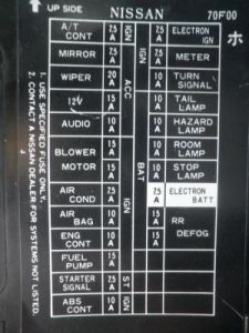

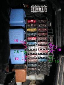

I was figuring the first two pictures were the SECU so I tried following the Red/white wire to the fuse.
I was unable to follow it due to the plethora of wires behind the fuse box and I also couldn't find the fuse at all for the windows (some fuses are at wrong rating)
https://www.2carpros.com/forum/automotive_pictures/442448_temp3_3.jpg
https://www.2carpros.com/forum/automotive_pictures/442448_temp4_1.jpg
Where would this fuse be??
https://www.2carpros.com/forum/automotive_pictures/442448_temp1_1.jpg
Thank you
Alex
Monday, January 18th, 2010 AT 4:21 PM
  • 110,192 POSTS
It's hard to tell from the picture. It looks like a relay.
Thursday, January 21st, 2010 AT 8:35 PM

My chilton manual shows a power window relay around the same area as the fuse box but more aft. I took out the bracket that screws three relays together but cannot figure which one the window relay is? There are two black and one blue relays (I can get a picture if you want).
