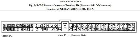

1 . Check Vacuum Source To EGR Valve - Start engine and warm to operating temperature. Disconnect hose from EGR valve and check vacuum. Vacuum should not be present. Raise engine speed to about 2000 RPM and check vacuum. Vacuum should be present. If vacuum is not as specified, go to next step. If vacuum is as specified, inspect EGR valve and EGR Control-BPT valve. Refer to SYSTEM/COMPONENT TESTS article. Repair or replace as necessary and perform FINAL CHECK in this article.

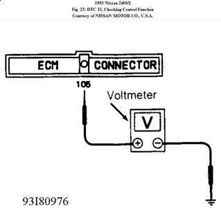

2 . Check Control Function - If vacuum is not present at about 2000 RPM, measure voltage between ECM terminal No. 105 and ground. See Fig. 3 and Fig. 23 . At idle, voltage should be about zero volts. At 2000 RPM, voltage should be battery voltage. If voltage is not as specified, go to next step. If voltage is as specified, inspect vacuum hose for clogging, cracks or proper connection. Repair vacuum hose as necessary.

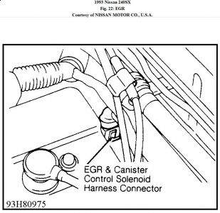

3 . Check Power Supply - Turn ignition off. Disconnect EGR and canister control solenoid valve harness connector. See Fig. 22 . Turn ignition on. Measure voltage between harness connector terminal "b" (Brown wire) and ground. See Fig. 24 . If battery voltage is not present, check 10-amp fuse, wiring harness and harness connectors. Repair or replace as necessary. If battery voltage is present, go to next step.

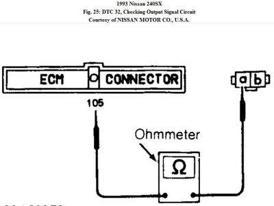

4 . Check Output Signal Circuit - Turn engine off. Leave ECM disconnected. Check continuity between ECM terminal No. 105 and EGR and canister control solenoid valve harness connector terminal "a" (Light Green wire) See Fig. 3 and Fig. 25 . If continuity is present, go to next step. If continuity is not present, repair harness or connectors as necessary.

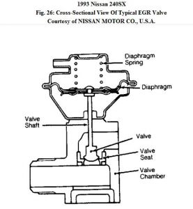

Here are the testing procedures.
EGR Valve
Using a hand-held vacuum pump, apply vacuum to EGR valve diaphragm. See Fig. 26 . Replace EGR valve if pintle does not open.

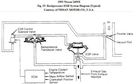

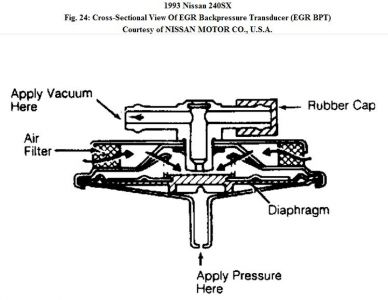

EGR Backpressure Transducer (EGR-BPT)
Plug one port of EGR backpressure transducer (EGR-BPT) and apply vacuum to other port. See Fig. 24 and Fig. 25 . Vacuum should NOT hold. Apply light pressure to bottom port (DO NOT apply more pressure than is necessary to cause vacuum to hold). If vacuum does not hold with pressure applied, replace EGR-BPT valve.
https://www.2carpros.com/forum/automotive_pictures/192750_EGRBPT93_240SXFig24_1.jpg
https://www.2carpros.com/forum/automotive_pictures/192750_EGRBPT93_240SXFig25_1.jpg

I just did the vacuum test for the EGR valve, should it hold the pressure? Because my egr valve did and the spring in side the egr want up.
Tuesday, January 12th, 2010 AT 3:34 PM
KHLOW2008
  • 41,814 POSTS
Yes, the valve must hold vacumn. If is faulty if it cannot hold vacumn.

Does that also apply to the BPT valve?
Wednesday, January 13th, 2010 AT 11:24 AM
KHLOW2008
  • 41,814 POSTS
The BPT would not hold vacumn until pressure is applied to the port as indicated in the diagram.

3) it says to apply little pressure to the bottom of the bpt when testing the bpt- pressure in which way? Do I push up on it? Squeeze the horse a bit that is connected to it? Or?

3. Apply pressure means using low air pressure to push the diaphragm. A hand pump would be the desired choice.
