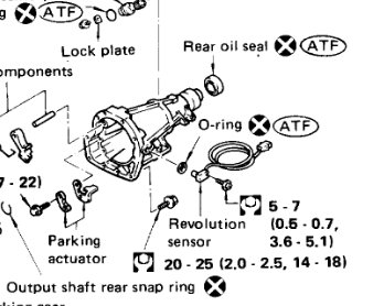

I just purchased a 1992 Nissan 240sx and the digital speedometer won't work can you help me fix it

This sounds like the VSS vehicle speed sensor is not working here is the location of the sensor. They call it a revolution sensor
LH Side of Transmission in tail shaft.
