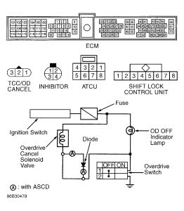

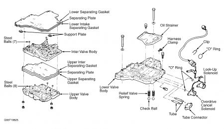

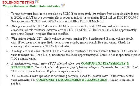

MY TORC CONVERTER INTERMIDDENTLY LOCKS IN. IS THERE A SENSOR THAT CONTROLS THE LOCK TORC CONVERTER?
Tuesday, February 24th, 2009 AT 9:00 AM
3 Replies
ZACKMAN
  • 4,202 POSTS
It is the Torque Converter Clutch Solenoid valve located in the valve body.

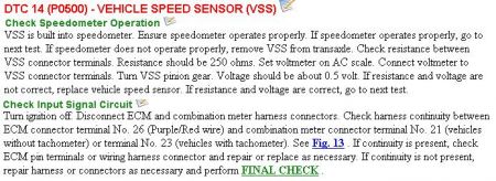

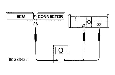

MARKCTS
The code I'm getting from my actron OBDII P0500
speed sensor failing could this be the problem or is that another problem?
Thanks
Mark
Tuesday, February 24th, 2009 AT 2:14 PM
ZACKMAN
  • 4,202 POSTS
My apology. Your original request was TCC operations. That was what I gave you. P0500 will indeed give you the "jerkiness" or shudder in driving.
Here is the diagnostic for P0500
https://www.2carpros.com/forum/automotive_pictures/55316_95sentrap0500_1.jpg
https://www.2carpros.com/forum/automotive_pictures/55316_95sentrap0500_2.jpg
