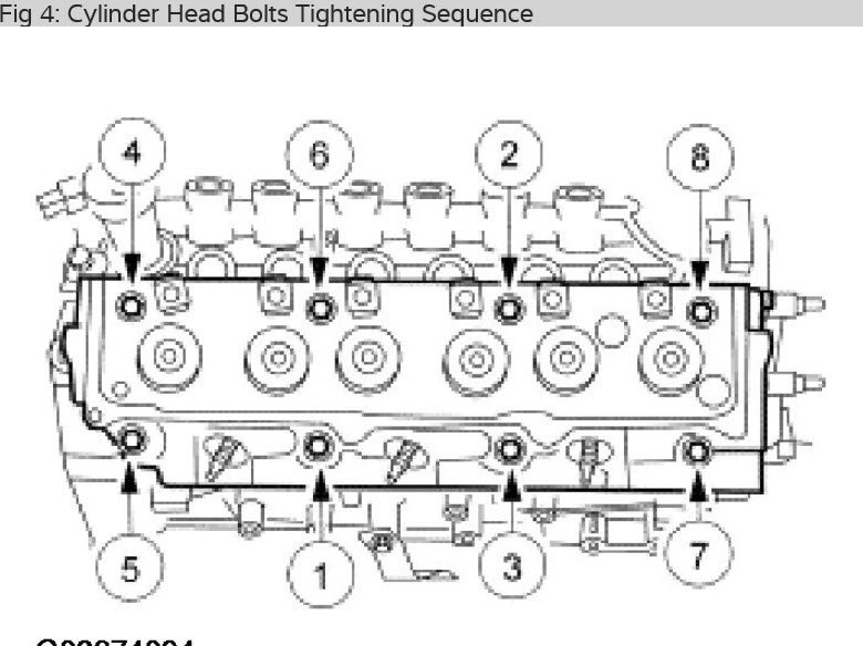

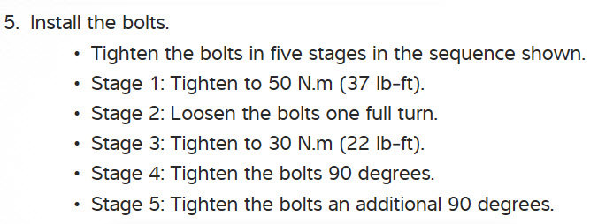

What is the torquing and tightening procedures and specs for cylinder heads on a 2004 Ford Ranger Edge 3.0 liter v-6.

You must use new cylinder head bolts as they are torqued to limit. Also, follow sequence it is a five step process. Also, head gaskets must face forward of engine. See pictures.
