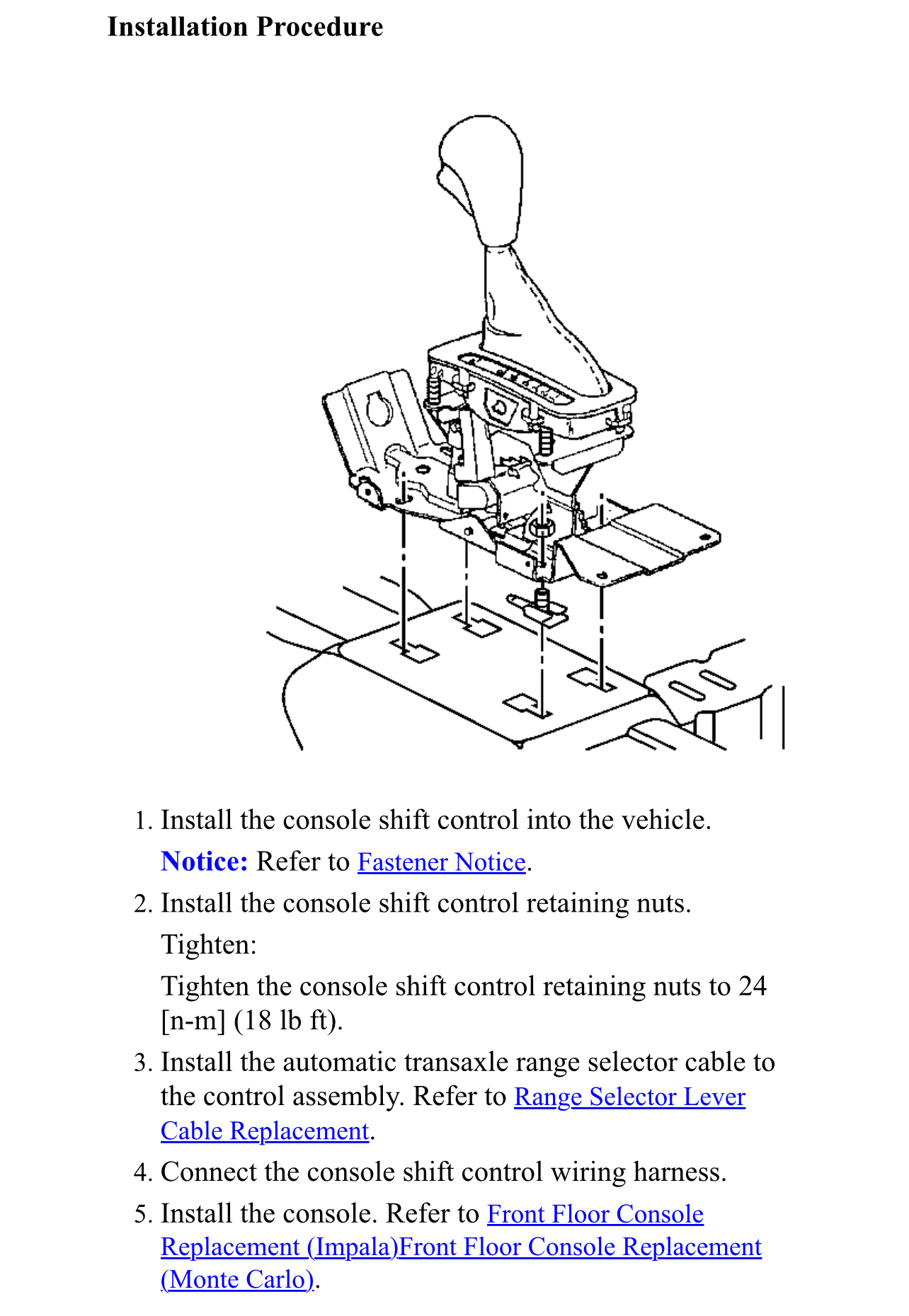

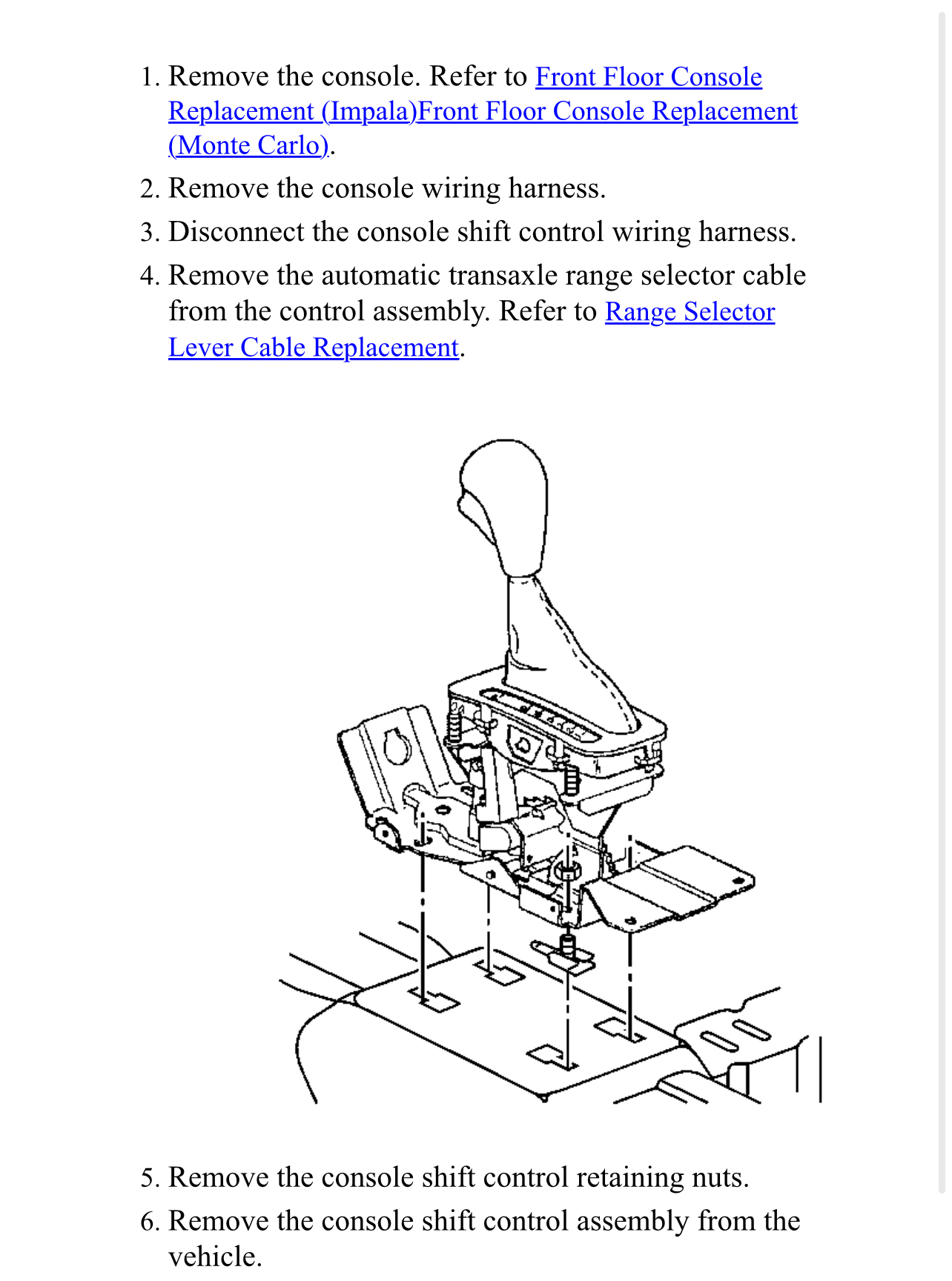

Transmission range sensor is built into the floor shifter assembly, it is not serviced separately, the floor shifter has to be replaced if the sensor is bad. I attached the link.

Hey Rob it's me again. I put the floor shifter in and the something, no gears on the dash and no start so I hotwired the starter and it's good what else could it be?
