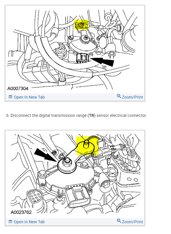

How can I put transmission in neutral without the ignition key
2005 FORD FREESTAR
170,000 MILES
JOSE JASSO
Lost my key need to move my car. how can I put it in neutral.
Sep 24, 2019 at 5:10 PM
  • CAR REPAIR CONTRIBUTOR
The only way I am aware of is to gain access to the top of the transmission where you can see the shift cable and remove the cable from the range sensor manual valve. Then you should be able to manually move the transmission to N. Obviously it should be in park and so you want to click that lever two positions so it is in N.
