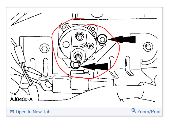

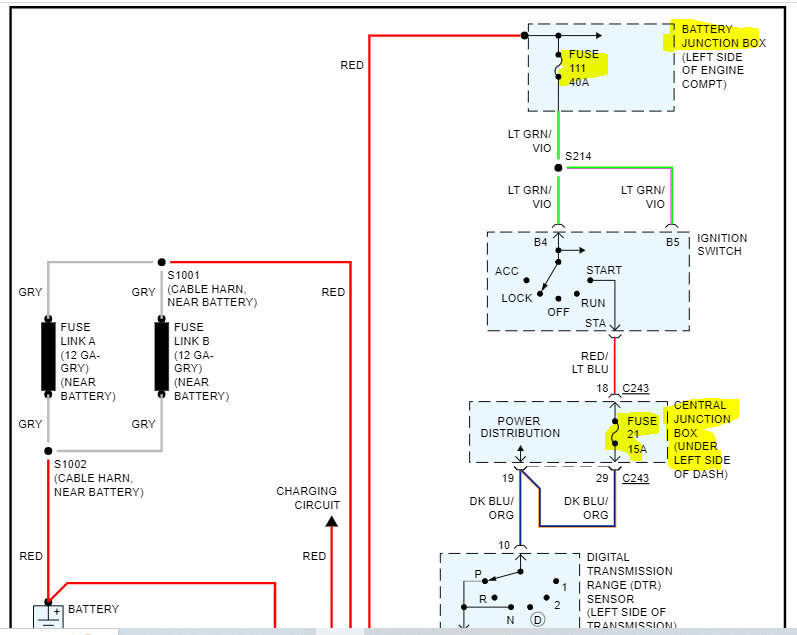

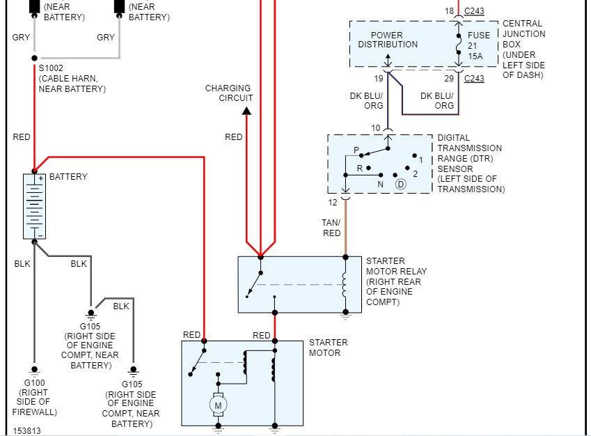

As far as the fuses and the starter solenoid relay are concerned, I attached info below in the wiring schematic. Take a look. I highlighted the fuses and their locations.
The last pic shows the solenoid/relay, which is under the hood, right rear of the engine compartment.
Let me know if this helps. Also, let me know if you are hearing anything now.

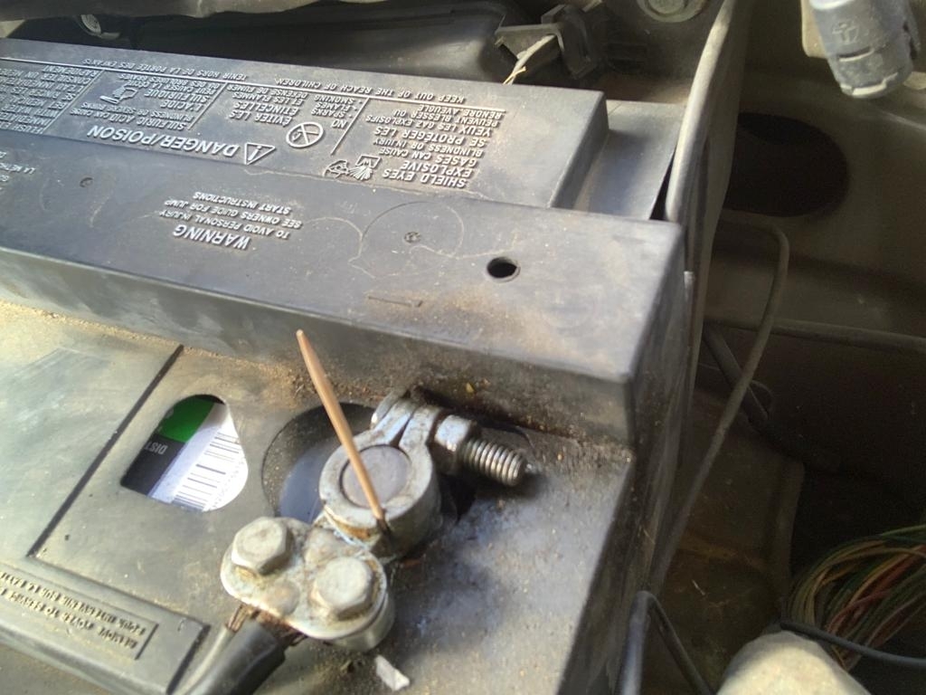

After trying to crank it, I then checked the battery posts. This is when I discovered something that I thought could be the problem. The first one shows the positive and negative battery posts. In this picture, it can be seen that there is a crack in the negative battery terminal connector. Could this be the cause of the problem. The second picture is that of the negative terminal connector alone. I inserted a toothpick in the crack just to provide a feel for the thickness of the crack. I don't know if the crack goes the whole length of the connector or not. I intend to go and buy a new connector in the next day or two to see if this fixes the problem.

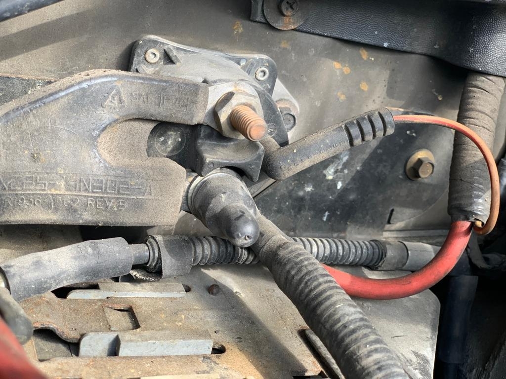

The last picture is what I think is the starter solenoid/relay. It is attached to the firewall on the passenger side of the car. Is this correct, and could this be what is faulty?

Yes, the terminal can cause it. If it isn't tight enough, it will lose contact when a heavy load is placed on it.
Also, yes that is the solenoid.

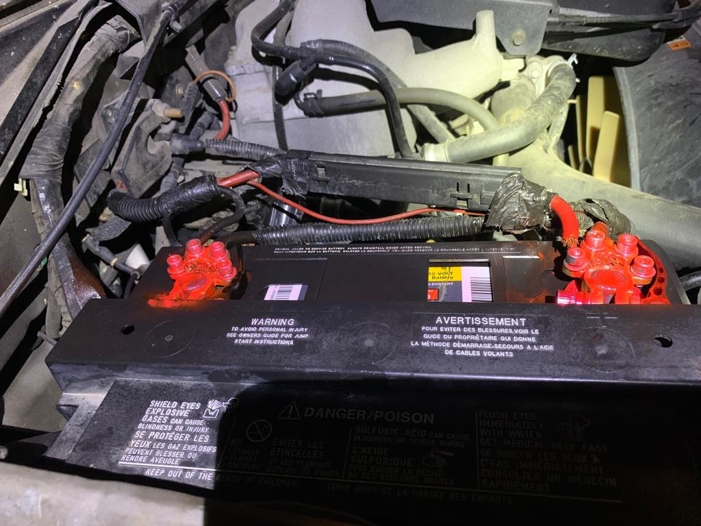

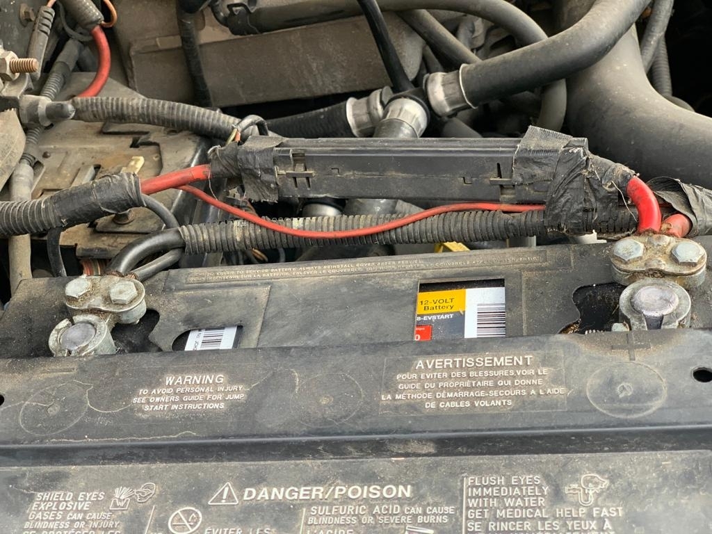

I thought I had fixed it the last time as I had reported. However, two days after leaving it on the driveway, it wouldn't start and made the same crackling noise as before. This was more concerning as I was going on vacation the next day. So, I left it on my driveway not working for about three weeks. I started wondering if something was wrong with the battery. My battery voltage however hovered around 12.3 and 12.4V. I then decided to bypass the starter solenoid relay by touching the negative and positive terminals on it with an insulated screwdriver while I had the ignition on, to see if the starter was the problem. The car wouldn't start but I could hear a single click from the area of the starter itself. I had noticed what seemed to be some slight corrosion on the positive cable and started suspecting if this was inhibiting electricity flow to the starter.

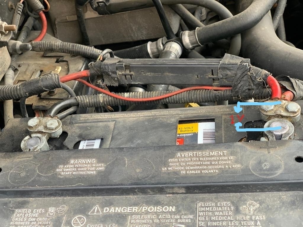

I then decided to jump the car to see if it would start. I did and let the other car run for about five minutes. Then I started my car and voila, it started. It seemed the voltage while charging was high enough to overcome any resistance in the wires. I later drove around a bit, then parked the car. After a while, I tried to start it, but it wouldn't start again. So, I decided that I better take more look at the cables. I then saw that the cable to the positive post of the battery was quite corroded. I measured the battery voltage from post to post, it was 12.3V. I then measured the voltage between the negative post of the battery and the end of the negative cable just before its plastic covering (see attached photo showing voltage drop), and it was 11.1V meaning there is a 1.2V drop over about one inch of negative cable that had the most corrosion. I decided to clean the cables and the battery posts with corrosion cleaner and then used a corrosion preventative. The last picture shows the terminals after cleaning. The red coloring is that of the corrosion preventative.
After this the car started much more easily. I'm keeping my fingers crossed, but it has started easily for the past two days.

Thank you for the update. A long, long time ago, my first shop teacher taught me that when there is any type of electrical concern, always start at the power source, the battery. That has stuck with me for a long time.
I looked at your pics. I noticed the connectors have been replaced. Make sure everything stays tight, including where the wire connects to the replacement terminal.
I suspect this has been the issue the entire time. Corrosion can certainly cause what you experienced.
