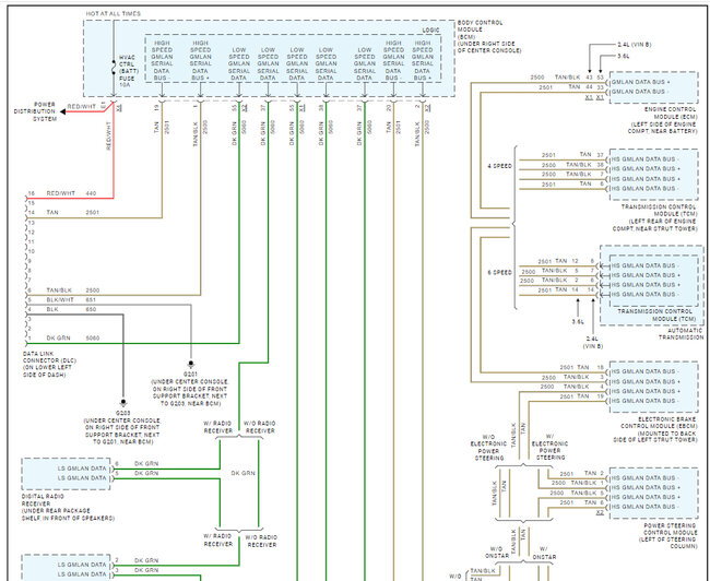

We have tried AutoZone's reader and my cheap one and I get power to the code reader tool, but I can’t get any data.
I tried looking through the fuses under dash and under-hood but I may have missed something. Any ideas?
Friday, July 5th, 2024 AT 8:57 PM
KEN L
  • MASTER CERTIFIED MECHANIC
  • 55,522 POSTS

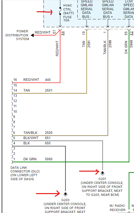

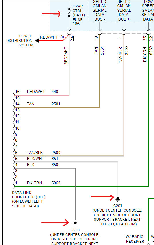

The data connector has one power lead and two grounds, I would use a test light to test for the power also check the HVAC control fuse in the fuse panel inside the car and check the data connector grounds.
Here is a guide to help with the test:

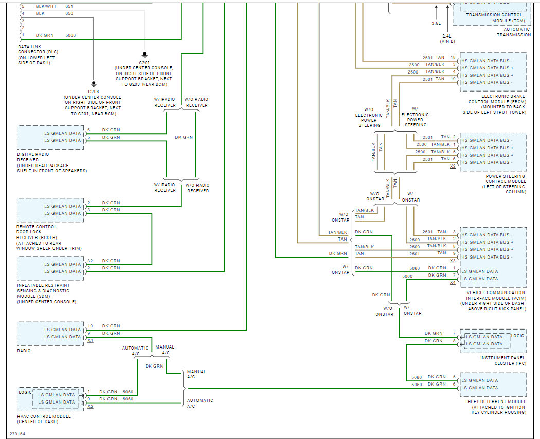

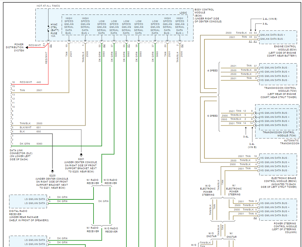

Here are the data connector wiring diagrams so you can see how the system works. I have marked the wires you should test. Check out the images (below). Please let us know what happens.
