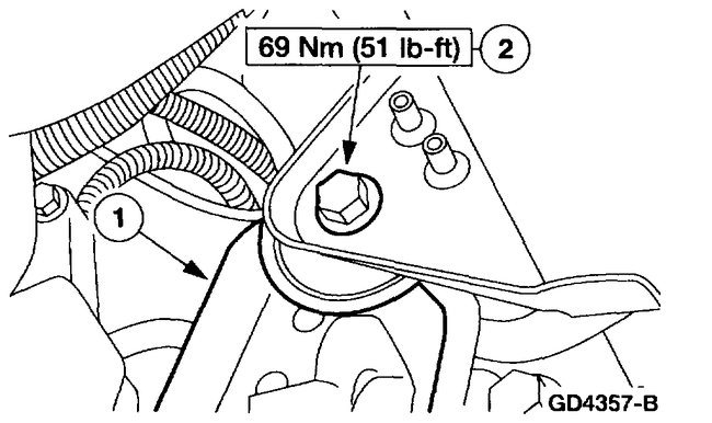

Hello, I need to replace both motor mounts and transmission mounts (Total 4). Can you tell me step-by-step how to replace each mount? My vehicle repair manual only shows how to replace the front motor mount, then it say’s the remaining mounts are about the same. I need more information than that. Please help, really need to know how to replace all four (4) mounts each step-by-step. Thank you.
Jun 20, 2019 at 7:06 AM
  • CAR REPAIR CONTRIBUTOR
  • 110,193 POSTS
Welcome to 2CarPros.

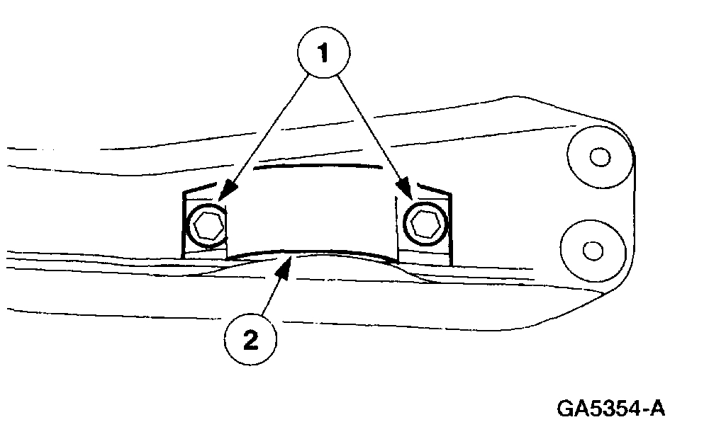

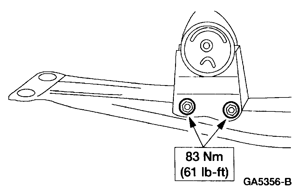

Here is everything I have. Let me know if it helps. The attached pics correlate with the directions.
________________________
Removal
1. Disconnect the battery ground cable.
2. Raise the vehicle.

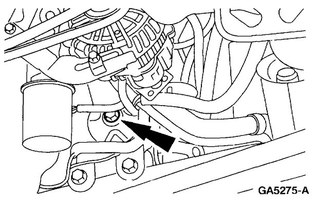

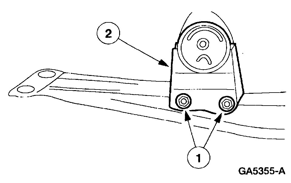

3. Remove the engine splash shields.
pic 1

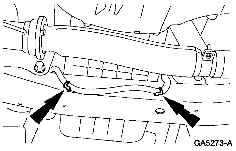

4. Unclip the Heated Oxygen Sensor (HO2S) wire harness.
pic 2

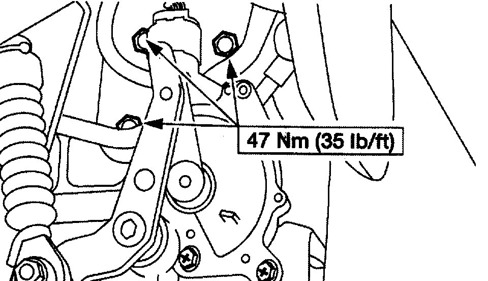

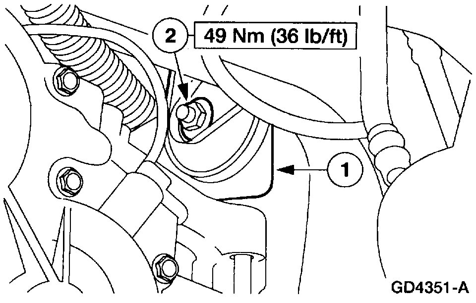

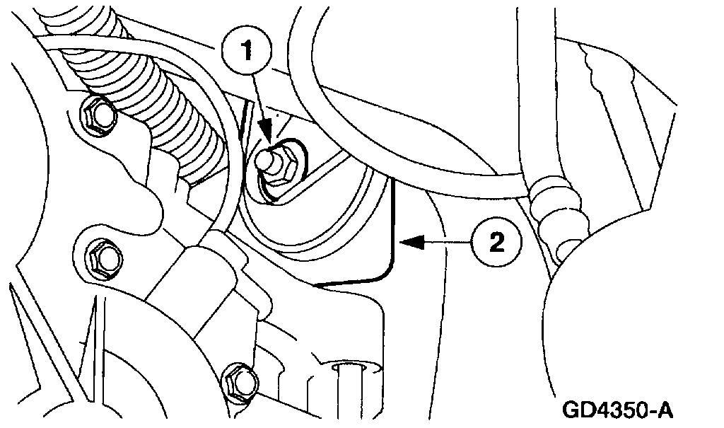

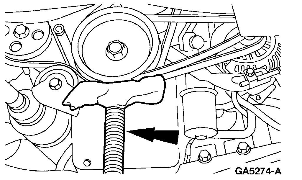

5. CAUTION: Cover the screw-type jack with a shop rag to prevent damage to the crankshaft pulley.
Position a screw-type jack under the crankshaft pulley.
pic 3

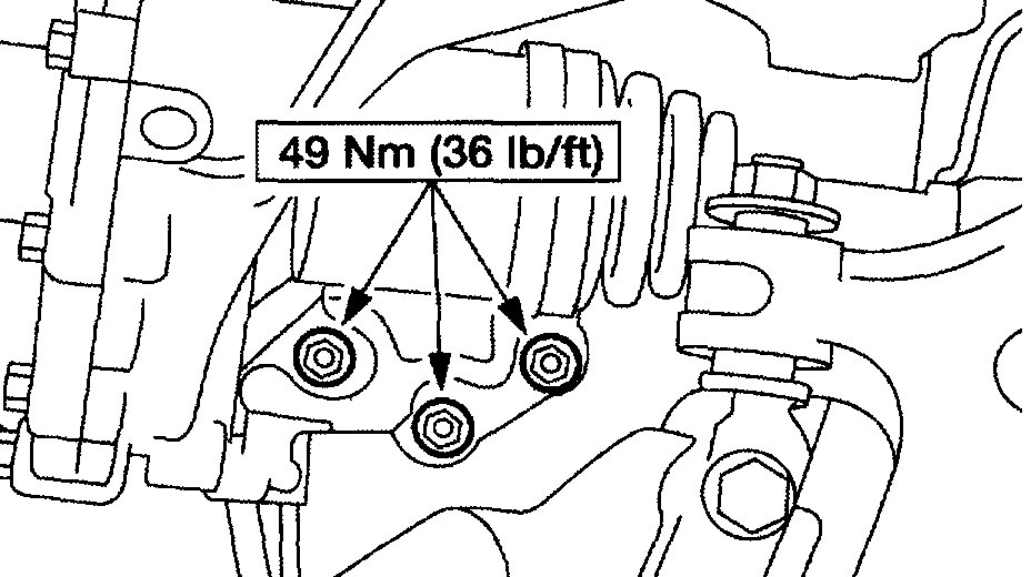

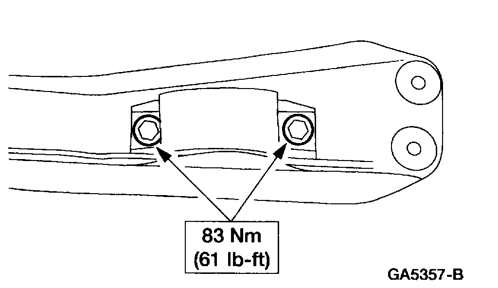

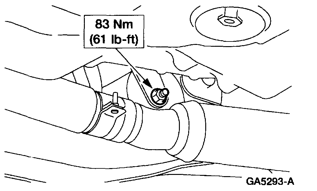

6. Remove the RH engine support insulator through bolt and nut.
pic 4

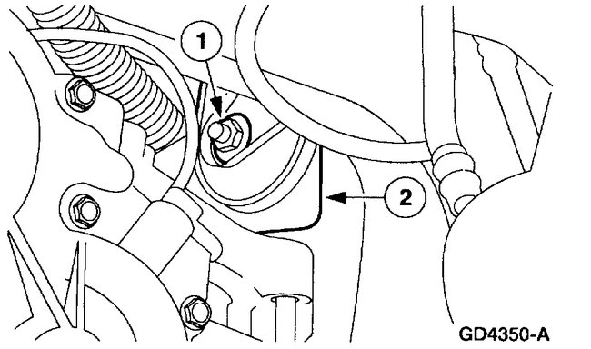

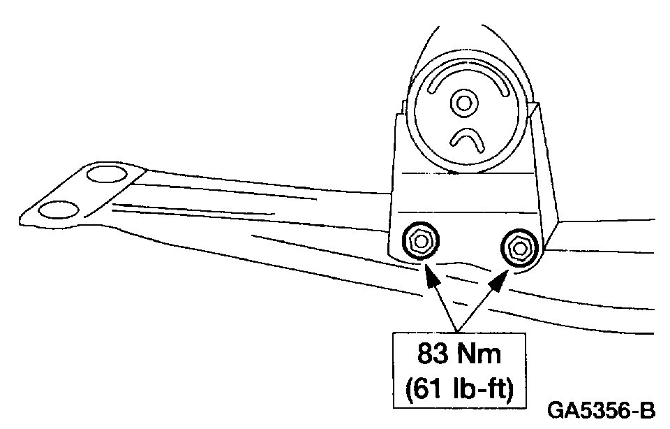

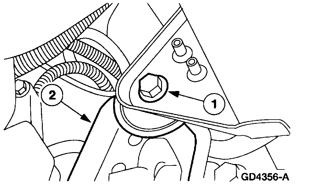

7. Remove the LH engine support insulator through bolt.
pic 5

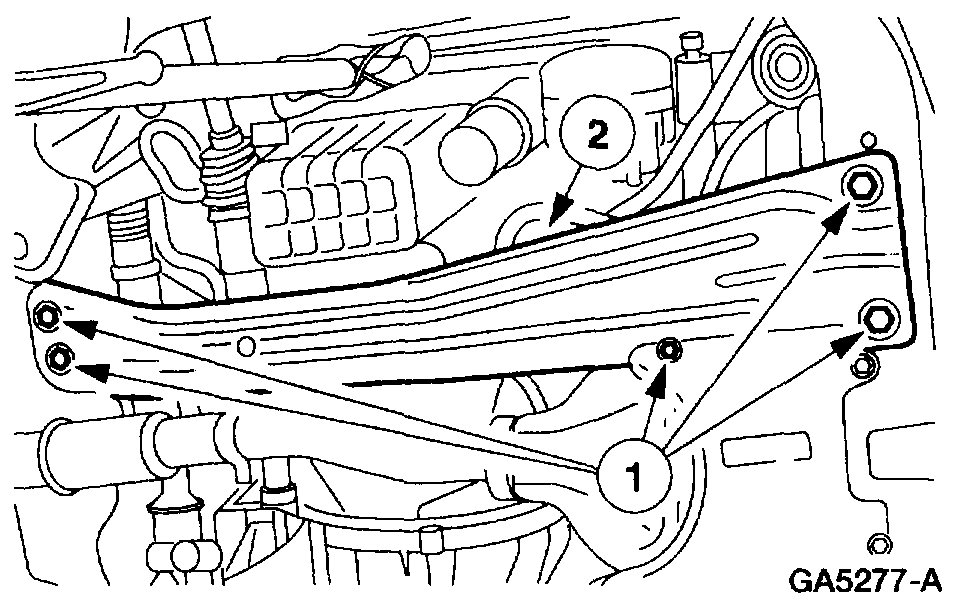

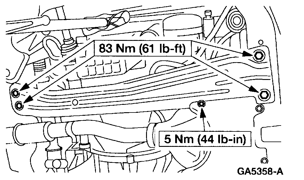

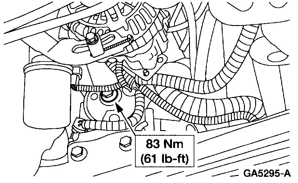

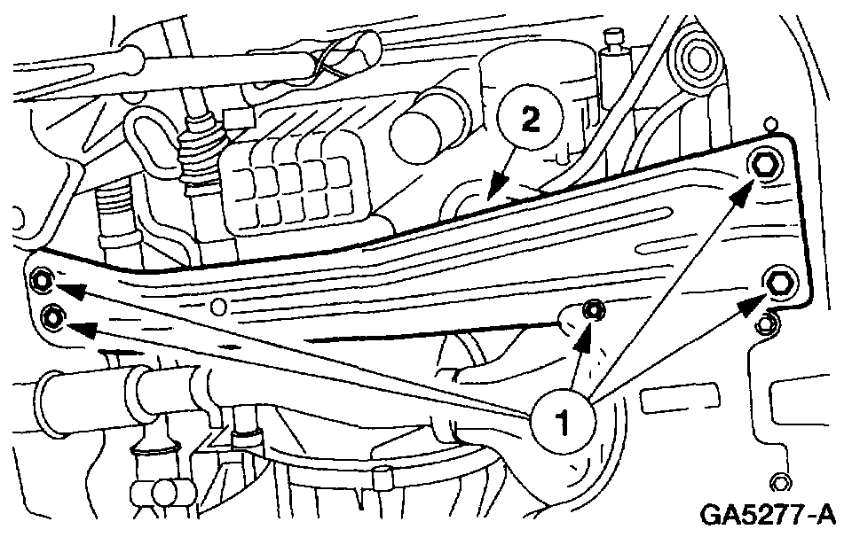

8. Remove the transverse member.
1 Remove the bolts.
2 Remove the transverse member.
pic 6

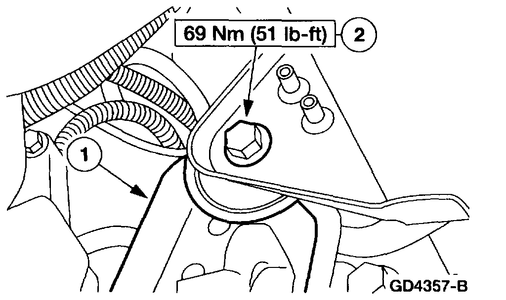

9. If removing the RH engine support insulator, remove the RH engine support insulator.
1 Remove the bolts.
2 Remove the RH engine support insulator.
pic7
10. If removing the LH engine support insulator, remove the LH engine support insulator.
1 Remove the nuts and bolts.
2 Remove the LH engine support insulator.
Installation
pic 8
pic 9
pic 10
pic 11
pic 12
1. To install, reverse the removal procedure.
_______________________________________
