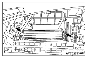

Where can I find the air cabin filter in 2009 out lander and how can I replace it. Thanks

REPLACE THE CLEAN AIR FILTER
Remove the glove box.
Loosen the two lugs as shown to replace the clean air filter.
Install the glove box
