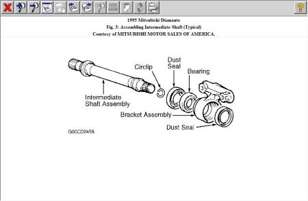

I have a 95 Mitsibushi Diamante ES with about 190000 miles with an V6 engine. I would like to know the reason that when I put my car in neutral and give it a push a clicking noise occurs. But when I look at my CV Joint it seems okay. Once before I replaced a bolt on some type of bracket which I think gave support to the CV Joint because it was doing the same thing but I do not know what it is called. Do you know what is the name of the bracket and what may be wrong with my car?

Its called the center bearing bracket see below is this the one you talking about. This the only bracket involved on the half shafts.
https://www.2carpros.com/forum/automotive_pictures/12900_bracket_1.jpg

Does your car have a posi or limited slip differential?
That will cause noise when moving if you are making a turn
