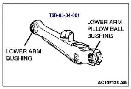

There is a TSB on the rear pillow bushing of the control arm:
https://images.2carpros.com/forum/automotive_pictures/30961_Pillow_bushing_1.jpg
You need to have a chat with the Service Manager on this. Ask him to go with you so he can hear it. Tell him you have been doing business with them and disappointed they are not meeting your needs. Look at this site http://www.mitsubishisucks.com/cars/complaints/usa/parts/suspension/lancer.html If you have a control arm problem like these you may get killed. Print the two here and show it to the Service Manager. Ask him to acknowlege on the bottom that he has read the two articles, in the event a problem happens, you'll have legal leverage.
