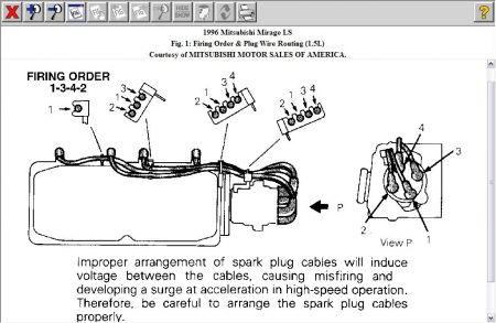

Mileage-124000km, 1460cc, 4G15 engine 4W drive DOHC 16valve 1996 model, manual transmission.
I want to know the engine firing sequence (order) because there is some noise under the valve cover. It looses power going uphill. This problem started when the plug cables were changed.

See below
