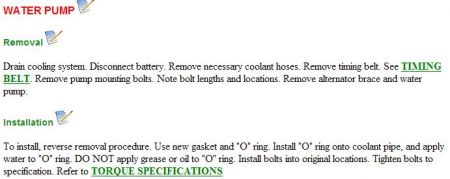

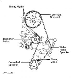

Hi. Your site looks great for those struggling with a repair.
My water pump just dies and I am going to strip it all down and replace it. Do you have any diagrams of the timing marks abd water pump fitting and removal you could post for me. Are these the same as the mitsi galant es?
I do not have a haynes manual. If you have no information I may be able to find something in the library.
Thanks very much
Steve

Hi there,
I need the model and engine size and I should be able to post what you need.
Mark (mhpautos)

NO1DAEMON
Sorry, forgot to mention that. The chassis number is E52A-0306962 and the engine number is 4G93-H81A
Thanks
Steve

MHPAUTOS
  • 31,938 POSTS
OK i found it, does help if i copy down the engine code correctly...
see pic & text for timing alignment & water pump R&R.
Mark (mhpautos)
