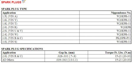

i need to know how big the gap on the spark plug is for this kind of truck
Friday, October 9th, 2009 AT 7:59 PM
SERVICE WRITER
MECHANIC
9,123 POSTS
The Mighty Max is a truck of it's own!!!!
