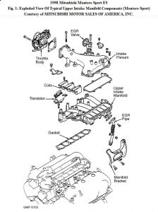

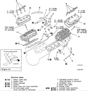

HI GOOD MORNING
WE HAVE IN MY SHOP A MITSUBISHI MONTERO SPORT 1998
WE PLANING CHANGE VALVE COVER GASKET
HOW TO DO CHANGE,
PLEASE IN CASE YOU CAN SEND PIC, IS GOOD FOR ME
THANKS SO MUCH

HI
SORRY BUT ONLY SEE THE PIC ABOUT PART
I NEED KNOW HOW TO CHANGE VALVE COVER GASKET
1998 MONTERO SPORT
Friday, October 9th, 2009 AT 8:52 AM
SERVICE WRITER
  • 9,123 POSTS
I have no ranr procedure. It take about 2 hours per side however.

I managed to gather some info on the replacement.
Remove air intake hose and ducts.
Remove ignition coils and accelerator cable bracket.
Remove EGR valve (if equipped).
Label and disconnect all cables, vacuum hoses, cooling system hoses, and electrical connections.
Remove manifold bracket.
Remove upper intake manifold.
https://www.2carpros.com/forum/automotive_pictures/192750_UpperIntakeManifold98MonteroSportsFig01_1.jpg
You would be able to access the valve covers. Remember to remove the hanger or any other brackets that might intefere with removal and installation of the valve cover.
