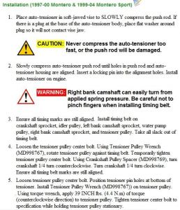

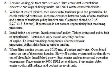

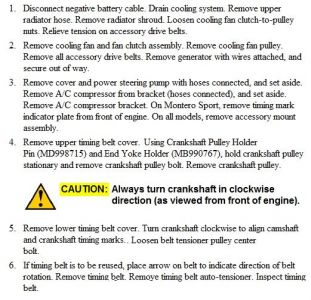

I am changing water pump and need a little info on changing timing belt. Never changed timing belt on these vehicles and I understand that timing belt may be a little difficult. Any info will helps. Thanks

https://www.2carpros.com/forum/automotive_pictures/261618_Noname_1986.jpg
https://www.2carpros.com/forum/automotive_pictures/261618_Noname2_641.jpg
https://www.2carpros.com/forum/automotive_pictures/261618_Noname3_252.jpg
