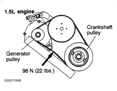

How do I get the altenator belt off?
Friday, September 4th, 2009 AT 2:42 PM
DOCFIXIT
MECHANIC
18,828 POSTS
Loosen top and bottom hold bolts then screw adjuster into to slacken belt.
