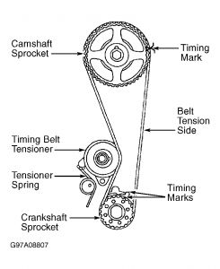

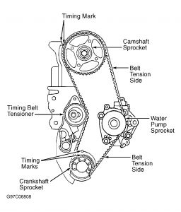

what do I have to do to replace the water pump on my 1997 mitsubishi mirage de? It looks like the right side of the engine needs o come apart.

WATER PUMP
Removal
Drain cooling system. Disconnect battery. Remove necessary coolant hoses. Remove timing belt . Remove pump mounting bolts. Note bolt lengths and locations. Remove generator brace and water pump.
Installation
To install, reverse removal procedure. Use NEW gasket and "O" ring. Install "O" ring onto coolant pipe, and apply water to "O" ring. DO NOT apply grease or oil to "O" ring. Install bolts into original locations
https://www.2carpros.com/forum/automotive_pictures/99387_Graphic1_184.jpg
https://www.2carpros.com/forum/automotive_pictures/99387_Graphic2_89.jpg
