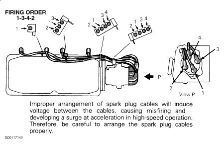

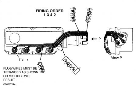

what is the fire secquence of a 1996 mitsubishi mirage

Hi there ,
One will be yours depending on your engine.
