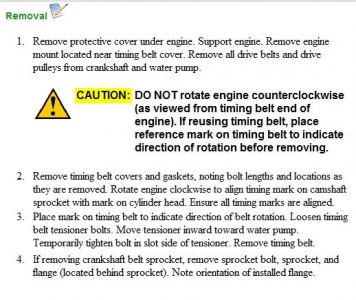

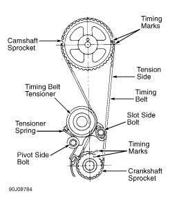

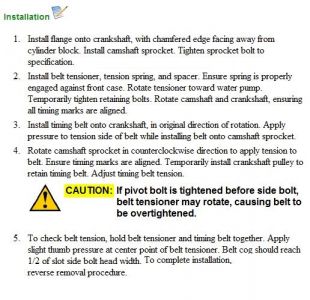

BLUELIGHTNIN6
MECHANIC
16,542 POSTS
+6
Sunday, May 23rd, 2010 AT 8:22 PM
