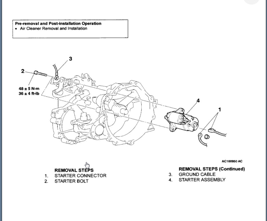

when i turn my key half of the times it just makes the whining noise but the engine will not turn over. sometimes if i just keep turning it the engine will start after a little while of turning the key. some people said that it might be a loose wire on the starter but i don't really know how to fix this problem.

This does sound like the starter is the issue but I don't think it is a loose wire. I suspect this is the solenoid on the starter that is failing.
Here is a guide that explains this:
https://www.2carpros.com/articles/how-a-starter-and-solenoid-works
Also, here is a guide that will show the location of the starter and how to replace it:
https://youtu.be/nDAIEc6T50k
Lastly here is the location and how to remove it from the manual. Let us know if you have other questions. Thanks
