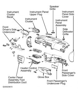

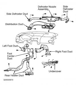

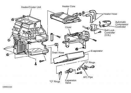

How do you get to the heater core

Remove this stuff see diagrams
