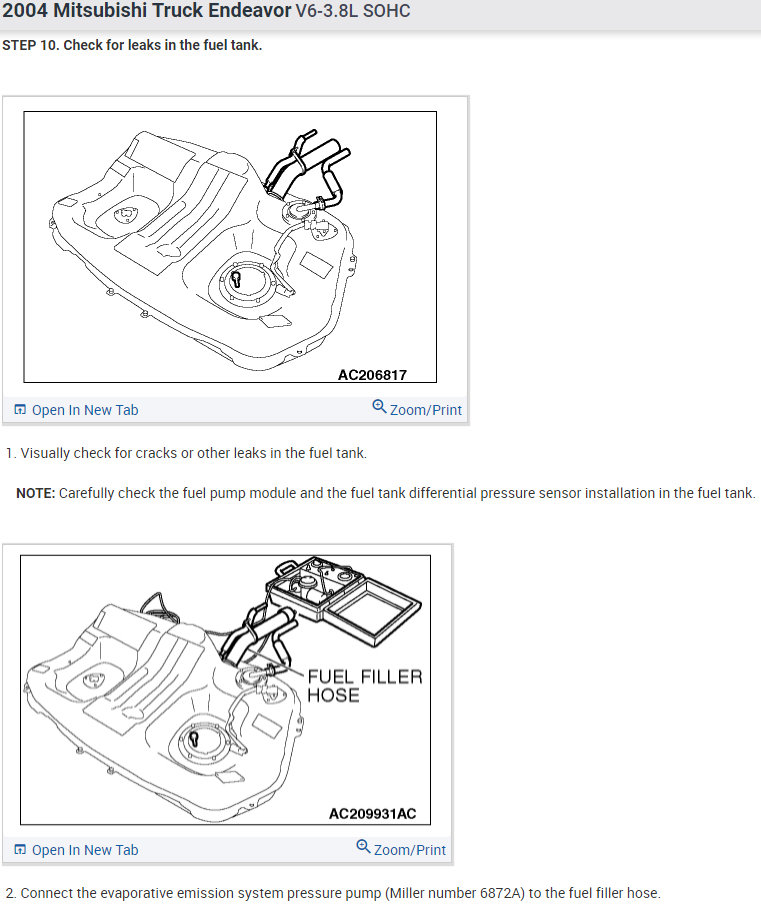

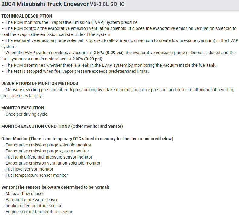

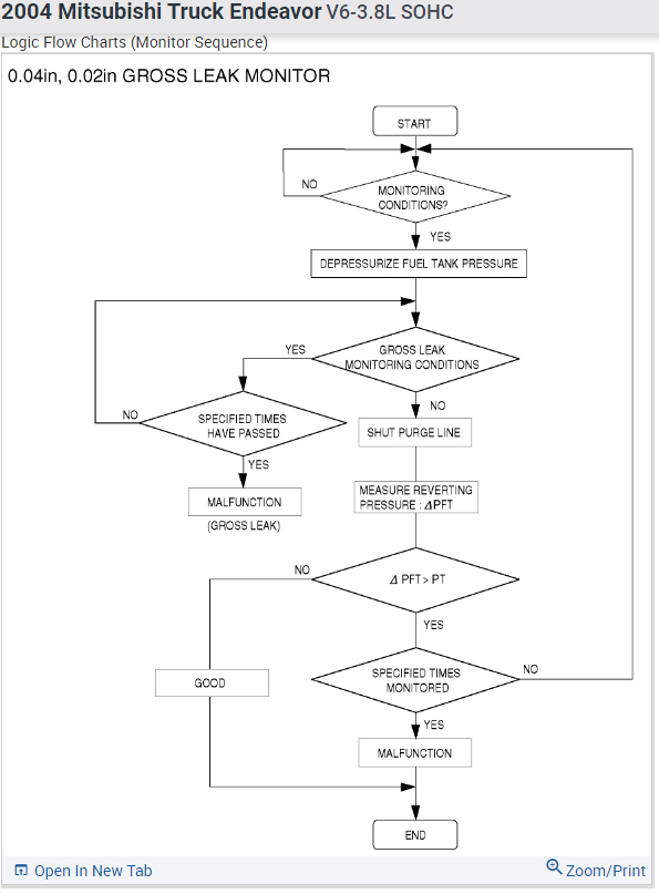

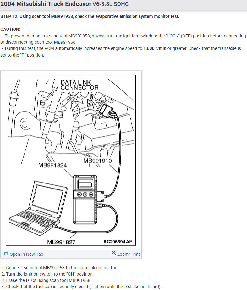

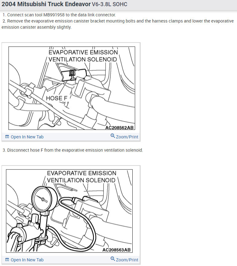

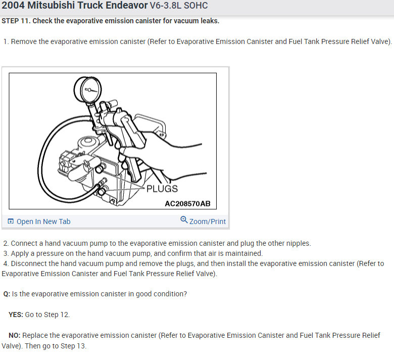

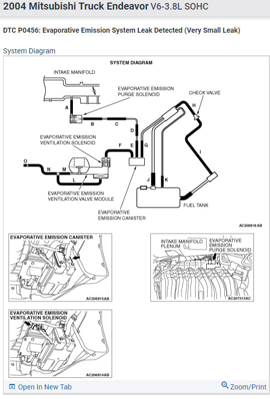

P0456 code?
JOHN BLAZER
  • 2004 MITSUBISHI ENDEAVOR
  • 6 CYL
  • AWD
  • 159,000 MILES

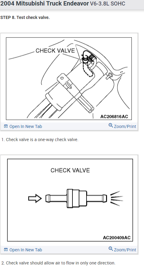

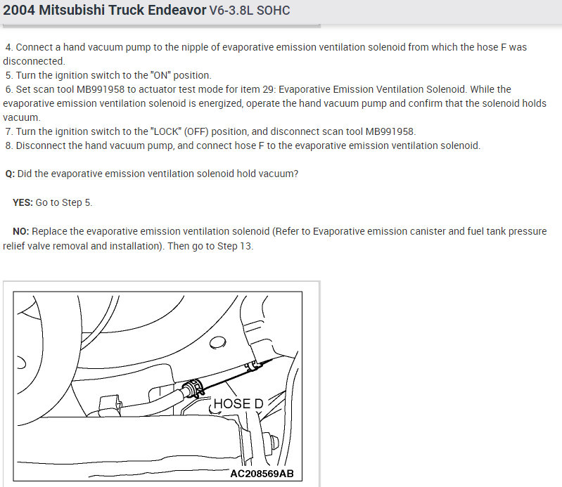

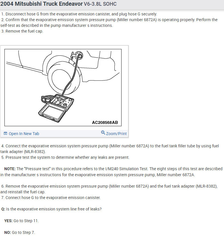

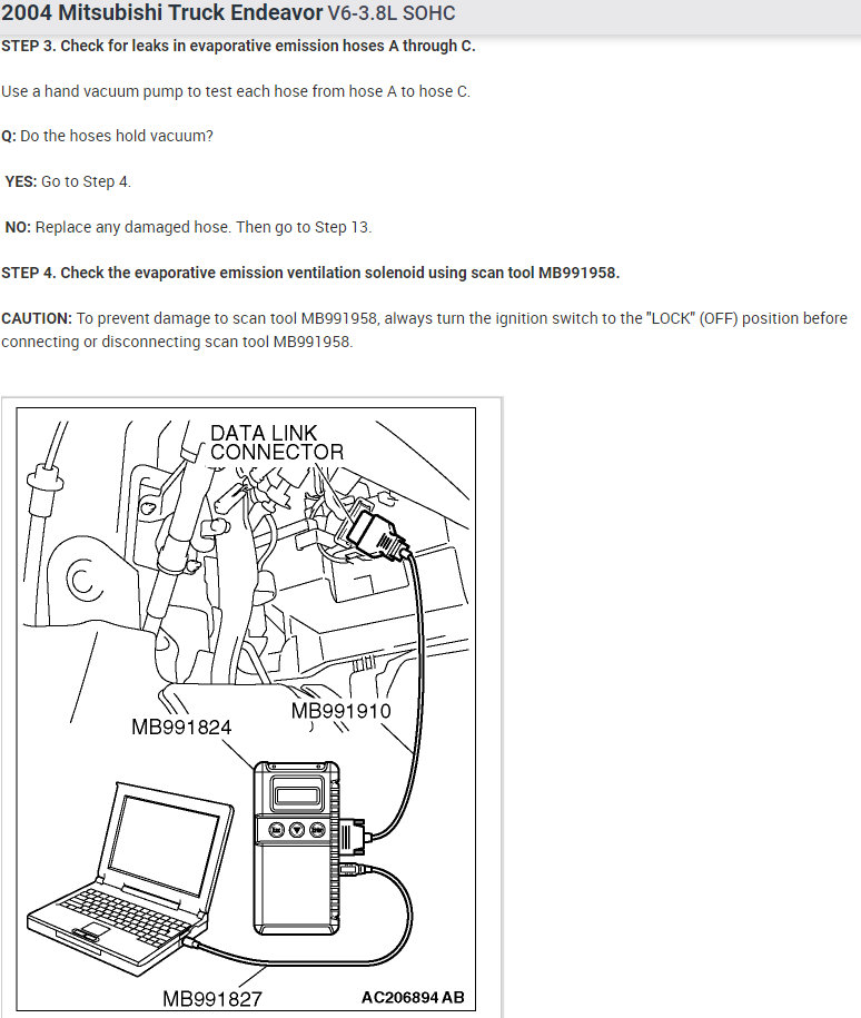

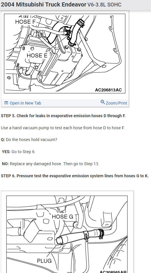

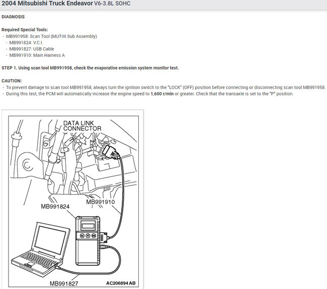

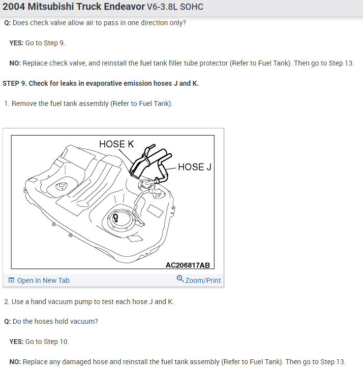

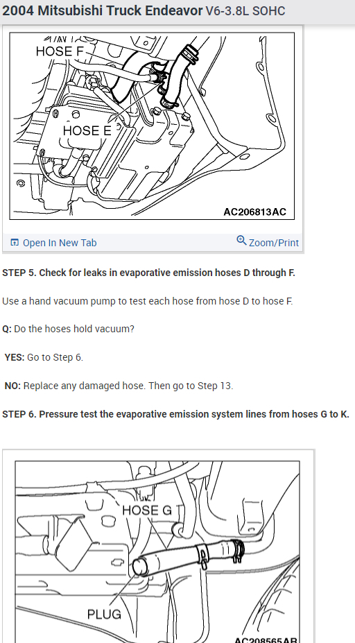

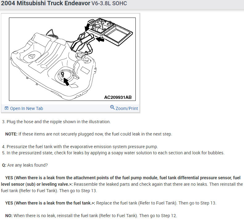

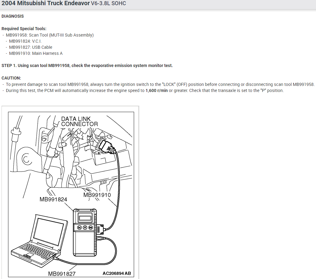

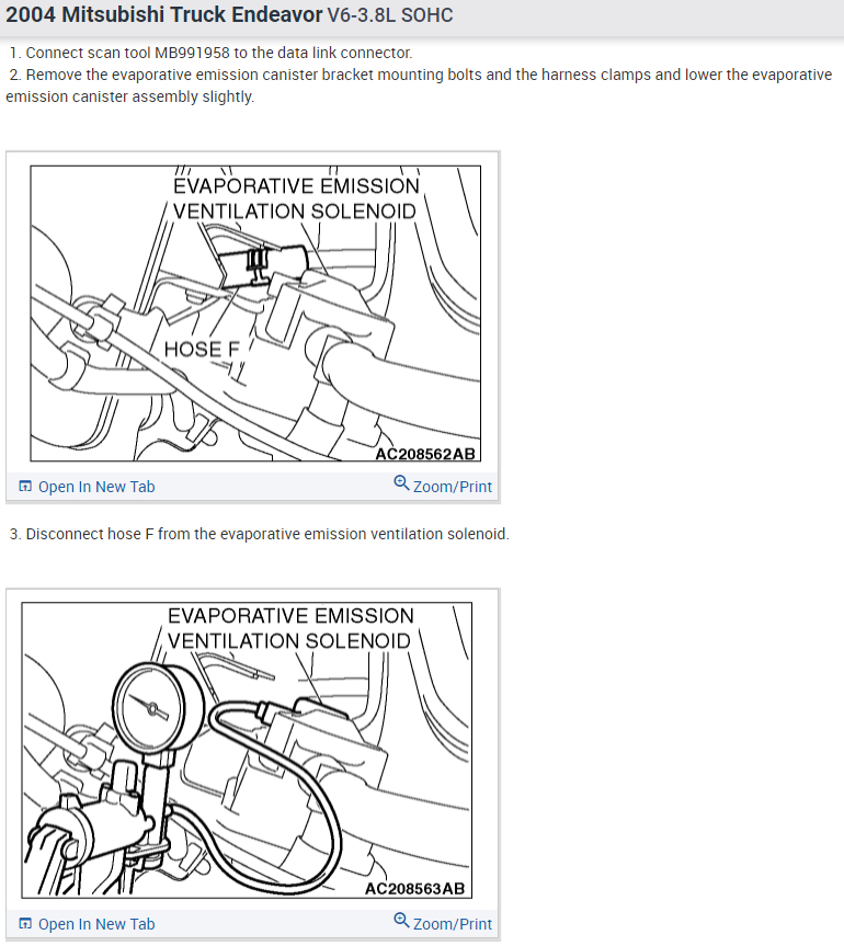

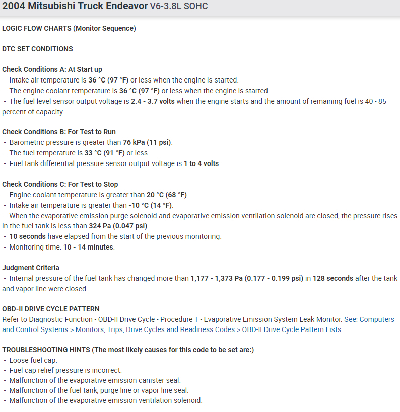

My endeavors service engine soon light is on. The code that came up was P0456 which is evaporative emission system leak. Can you suggest a fix
Monday, July 19th, 2010 AT 8:07 PM
SQM
  • 6,383 POSTS
There are several factors for that code to come on. It could be as simple as a lose or defective gas cap. It could also be a leak anywhere in the evaporative system, which could include the fuel tank or a faulty hose.
Have you made sure that your gas cap is on properly? Have you tried clearing the code?
Here is a video showing how to clear the code:
https://youtu.be/ahK_eucFi-k
https://youtu.be/iH92vcUWJzs
You also might find this article helpful:
https://www.2carpros.com/articles/how-emission-control-systems-work

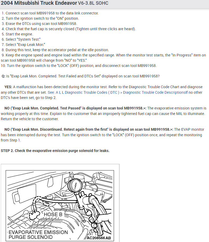

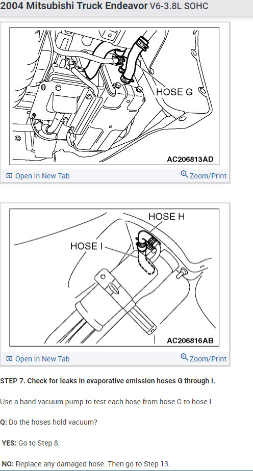

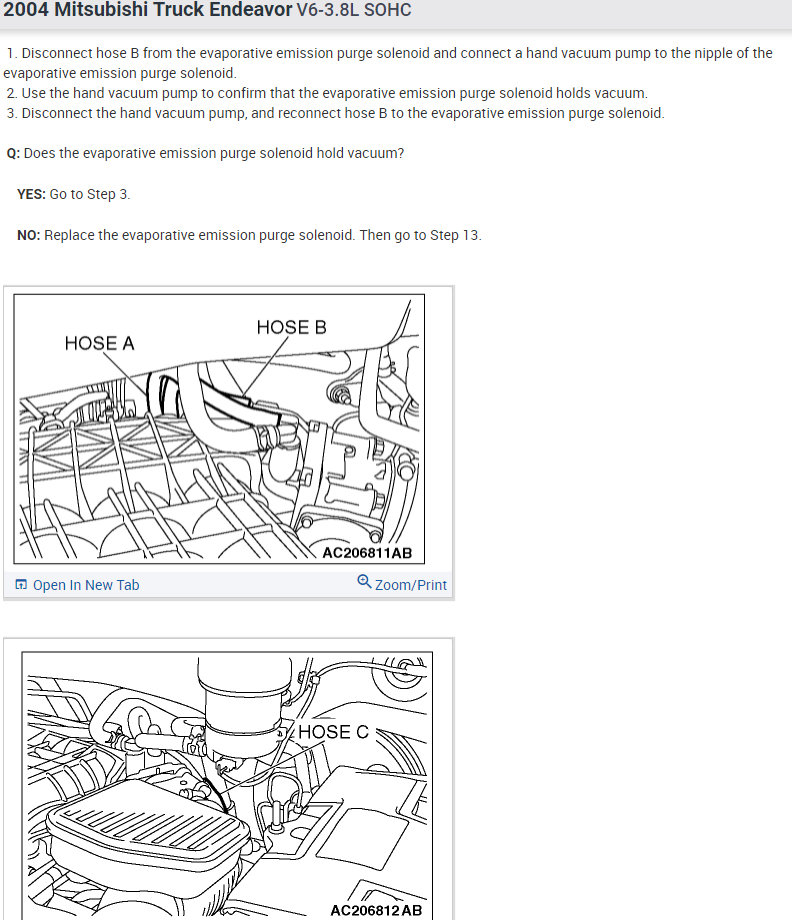

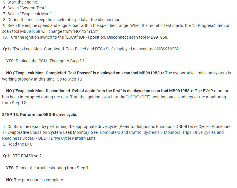

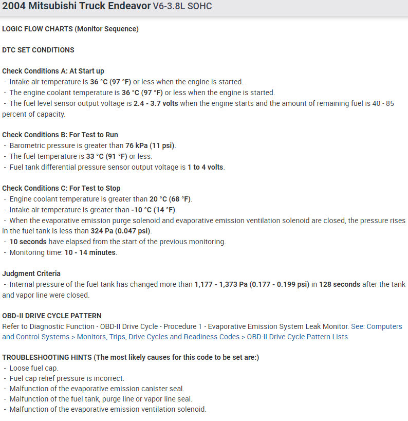

I have attached a step by step procedure of diagnose and determine what is the cause for the error code in your vehicle.
