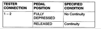

hi I was woundering if you could tell me where the neutral safety switch would be on a 2001 mitsubishi eclipse gs

CLUTCH INTERLOCK SWITCH CHECK AND ADJUSTMENT
https://www.2carpros.com/forum/automotive_pictures/12900_csm1_1.gif
1.Check to be sure that the interlock switch is as Shown in the illustration when the clutch pedal is depressed at its full stroke 130 mm (5.1 inches) . If the specified dimension is not met, loosen the clutch interlock switch 1/4 turns counterclockwise. Then slide the switch to the specified dimension, and turn the switch 1/4 turns clockwise to lock.
https://www.2carpros.com/forum/automotive_pictures/12900_csm2_1.gif
https://www.2carpros.com/forum/automotive_pictures/12900_csm3_1.gif
2.Connect an ohmmeter to the interlock switch connector, and then check for continuity when the clutch pedal is fully depressed and when it is released outward.
