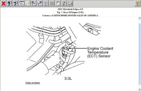

hello im am trying to locate the coolant temp sensor on my eclipse can u please tell me where it is?
Jul 2, 2009 at 4:35 PM
  • 75,992 POSTS
Its on rear center of engine near the coolant outlet Check out the diagrams (Below). Please let us know if you need anything else to get the problem fixed.

I am bout to find the ect sensor do you know where it is located on my 4G64 engine or 2.4L. I have looked all over the internet and no one will say.
Jan 18, 2021 at 11:37 AM (Merged)
by the thermostat housing.
