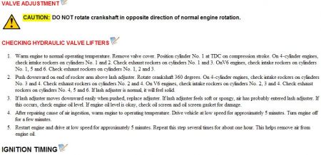

What would cause a clicking noise coming from the top of the engine that gets louder when you axcelerate?

Hi there,
You may have a faulty lash adjuster, here is the inspection method for them.
Mark (mhpautos)
