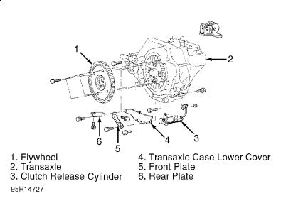

My clutch stopped working and smoke came from the hood clutch would not disengage

Ah its my clutch fork
how do I go about fixing that

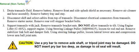

The transmission will have to be removed, do you have the equipment to do this job?

Yes how do I do it

Info on gear box removal
https://www.2carpros.com/forum/automotive_pictures/61395_clutch_mits_1.jpg
https://www.2carpros.com/forum/automotive_pictures/61395_mits_1_1.jpg
https://www.2carpros.com/forum/automotive_pictures/61395_mits_1.jpg
mark (mhpautos)
